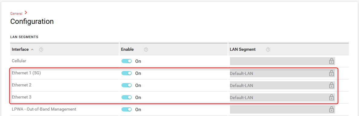

    You can also check your Ethernet port configuration under Hardware Interfaces > General > Configuration.
    Under Hardware Interfaces > General > Configuration, you can:
    • View a summary of the Ethernet interfaces
    • Enable or disable each interface
    • Add an Ethernet interface to a LAN Segment (if WAN AUTO DETECT is off for that interface).
    You can configure an Ethernet interface for WAN mode by leaving the LAN Segment field empty.
