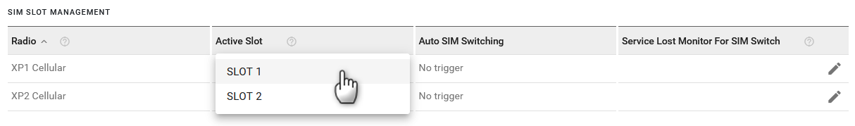

    1. Manual SIM Switching
      AirLink routers have two SIM card slots and can support a primary and secondary SIM card. By default, the upper SIM card (SLOT 1) is the primary SIM card used by the first cellular interface (“XP1” on the AirLink XR90, “Cellular” on the AirLink XR80), and the lower SIM card (SLOT 2) is used by the second cellular interface, if installed on the router (“XP2” on the XR90, “XP” on the XR80).
      You can reassign the active SIM slot in the SIM SLOT MANAGEMENT table (under Hardware Interfaces > Cellular Interfaces > Configuration). For example, if you want the router’s “Cellular” interface to use the SIM card in SLOT 2, you can select SLOT 2 in the table’s Active Slot column.

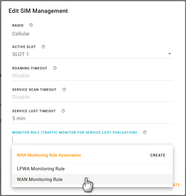

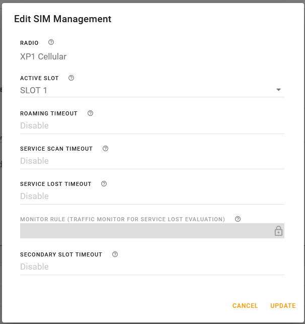

    Configuring Auto SIM Switching
    If your single-radio router has two SIM cards installed, you can configure the conditions for which the router automatically switches the SIM card being used for network connectivity.
    To configure Auto SIM Switching, click in the SIM SLOT MANAGEMENT table and enter the timeout settings that will trigger a SIM switch.
    The configurable cases are Roaming Timeout, Service Scan Timeout, Service Lost Timeout and Secondary Slot Timeout. These settings work together, so it’s important to plan how you want automatic SIM switching to work before configuring these fields in order to reduce network downtime on the cellular interface.

    MONITOR RULE (TRAFFIC MONITOR FOR SERVICE LOST EVALUATION)
    This setting is available when SERVICE LOST TIMEOUT is configured.
    Select an associated Network Watchdog Monitor Rule that will trigger the SERVICE LOST TIMEOUT to start.
    Click CREATE to create a new monitor rule. The Monitor Rule must monitor the Cellular interface. To configure a Monitor Rule, see Configuring the Network Watchdog.

    SECONDARY SLOT TIMEOUT
    If the router has been using the secondary SIM card for the time configured in this field (in minutes), the router automatically switches back to the primary SIM card. This allows you to configure the router to fall back to the primary network if, for example, the data rate is better on the primary network.
    Note that the router will switch SIM cards again if the Service Lost Timeout threshold is met again. Example: After switching back to the primary SIM card (with the Service Lost Timeout set to 30), if there is a service loss for 30 minutes, the SIM will switch to the secondary SIM card and the SECONDARY SLOT TIMEOUT begins again.
    1–65535 min
