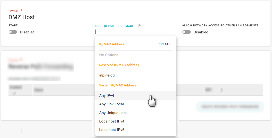

    1. Go to Networking > Firewall > DMZ Host.
    2. Under START, click the switch to enable DMZ Host.
    3. Under HOST DEVICE (IP OR MAC), select the device to be the DMZ Host.
      The options are:
      • IP/MAC Address: Any manually configured DMZ Host (see steps a, b and c below)
      • Reserved IP/MAC Address: Any configured Fixed IP Assignment(s). In this example, alpine-ctr is the configured device. See Configuring DHCP Reservation (Fixed IP Assignments) for more information.
      • System IP/MAC Address: These options are created by the system automatically, and their IPv4/IPv6 Address or CIDR ranges are shown in the SYSTEM DEVICES table at Zones Settings > Device IP/Network. See Configuring Device IP/Network for more information.
        • Any IPv4: Any IPv4 address
        • Any Link Local: Any link local IPv6 address
        • Any Unique Local: Any unique local IPv6 address
        • Localhost IPv4
        • Localhost IPv6
      If none of the existing options meet your needs, click CREATE to configure your own DMZ Host.
