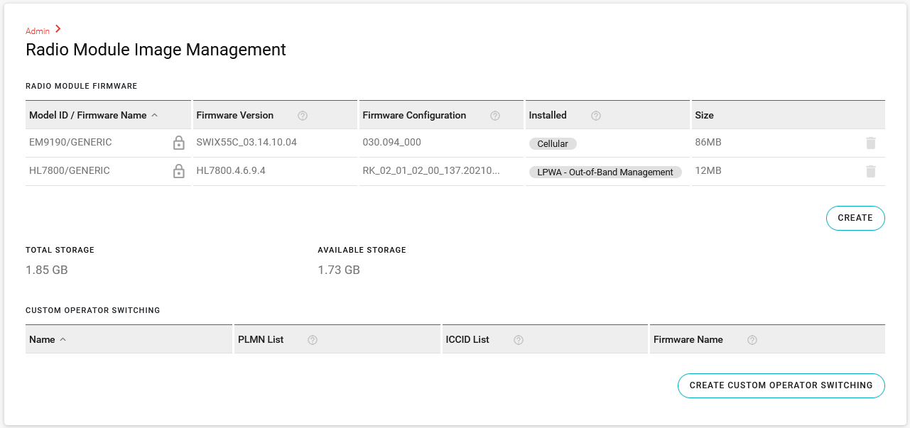

    The CUSTOM OPERATOR SWITCHING (COS) is only used when RMFW image switching is automatic. When the router sees a SIM, and is set to automatic, then the COS table is checked first. If there is no relevant COS definition, then the internal database defines which RMFW to use.
    Example: If Bell issues a new SIM that has a different Public Land Mobile Network(PLMN) or Integrated Circuit Card Identifier(ICCID) than what is defined in the internal database, then a definition using COS to associate the new PLMN or ICCID to an existing carrier firmware is created.
    In the above example,
    • If a SIM with PLMN 20801 or 20820 is detected, the system will use BELL RMFW.
    • If a SIM with an ICCID starting with “89330121313814” is detected, TELSTRA RMFW will be used.

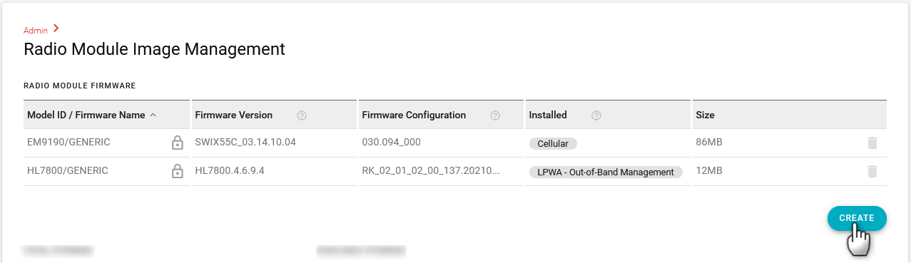

    1. Click CREATE.
    2. Click on the entry line to select the desired module/carrier combination from the list.

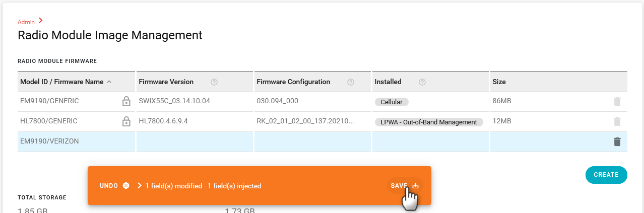

    3. Click CREATE to add a radio module firmware entry in the table.
    4. Click SAVE and a new row for the selected carrier appears. The FIRMWARE CONFIGURATION and FIRMWARE VERSION fields are blank.
    5. Reboot the router, which will perform an Airlink OS update that will retrieve the RMFW and add it to the router. After reboot, the router executes several checks and the RMFW image switch occurs based on the SIM that was inserted, as indicated by the green LED chase pattern. The update should take 2–5 minutes, depending on the RMFW version it is updating to.
