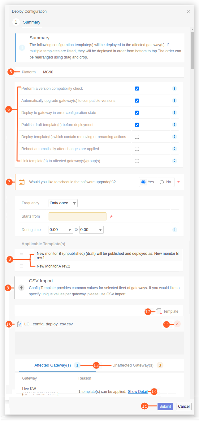

    • Deploy: deploys the selected template(s) to the selected device(s).

    Template Deployment Applies configuration elements in the template to one or more managed device(s). The AMM will generate configuration changes based on template and device data. The AMM will also check the current device state, to deploy the configuration immediately, or hold on to the configuration in staging and wait for certain criteria to be fulfilled, such as the completion of a software update, or for the device to check in.
    Linked Template(s) Template(s) that have been deployed to a device or group.

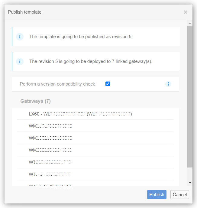

    Publishing a Template
    Basic Publishing and Revisioning
    Once you are done configuring your template (as described in Creating a New Template from Scratch and Creating a Template from a Device), click Submit.
    If the template passes validation checks, the AMM stores a draft revision of the template which is indicated by the Draft link in the Revision column on the Configuration Template screen :
    Before the template can be applied to devices, it must first be published to a numeric revision:
    1. Click on Draft to open the template.
    2. (Optional) Perform any additional edits to the template.
    3. Click Publish at the bottom of the template configuration screen:
    A confirmation popup will appear indicating the revision number that the template will be published as:
    4. Click Publish on the confirmation popup.
    After the template has been published, its revision number is indicated in the Revision column on the Configuration Template screen:
    Hover the mouse over the revision number to see a popup with information about when the revision was published:
    Publishing a new Revision
    Follow the steps below to create a new revision of a published template:
    1. Click on the template’s name in the template list on the Configuration Template screen:
    2. (Optional) Edit the new template’s fields when the Edit Template screen appears.
    3. (Optional) Click Save or Save As to save the template as a Draft revision. Selecting Save As, will create a new template with the same settings as the original template. The newly created template will not have any entries under the Linked to and Generated from columns.
    4. Click Publish to create a new revision of the template. A confirmation popup will appear indicating the new revision number that the template will be published as.
    Note: If there are any linked gateway(s) to the template, then when you publish a new version of the template, it triggers the AMM to automatically apply the latest configuration changes to those linked gateway(s). A confirmation popup window will list the affected gateway(s). For AMM 2.17, the version compatibility check is ignored in this workflow. For 2.17.1+, there is an option Perform a version compatibility check which is enabled by default. This check will verify that the template is compatible with the software version on the gateway device(s). This should not be disabled, unless it has been thoroughly tested.
    Note: Any untested changes should not be published to a template with linked gateways, as this can result in misconfigured gateways
    5. Click Publish on the confirmation popup.
    After the template has been published, its new revision number is indicated in the Revision column , along with any previous revision numbers.
    Note: If there are any linked gateway(s) to the template, then the AMM UI will navigate to the Configuration Control screen and show the gateway config states as Pending - sync to device. This shows that the AMM is attempting to apply the template to the gateways.
    Note: For AMM 2.17 and below, you can only abort this process by quickly reverting the gateway before the operation is completed.
    For 2.17.1 and above, you can abort the process by navigating to the Operations page. Then select the created template deployment operation, and click the Cancel button before the deployment has completed.

    Follow the steps below to deploy templates:
    1. Open the Configuration Template screen.
    2. Click on the gateway or group of gateways in the Gateway tree that you want to deploy templates to. This displays checkboxes to the left of each template listed that can be applied to the device(s) or group(s):
    3. Click the checkboxes to select the template(s) to deploy.
    4. Click Deploy . The Deploy Configuration popup appears:
    The popup displays the following information, and one or more of the following options depending on the state of the selected device(s) and configuration template(s):
    • Platform : displays the platform(s) to which the templates belong.
    • Options :
      • Perform a version compatibility check: displayed if a software version mismatch is found between the selected gateway(s) and the selected templates. If enabled, a new option will be displayed Automatically upgrade gateway(s) to compatible versions. If the new option Automatically upgrade gateway(s) to compatible versions is checked, an additional new option will be displayed asking if you want to schedule the software upgrade or not . If Yes is selected than a schedule editing panel is inserted into the page for you to select an upgrade schedule. If No is selected, the upgrade will take effect immmediately.
        The template will only be deployed and linked to a gateway if their software versions are compatible. This option is selected by default and is recommended because the use of a template that targets the same software version as the gateway, has the best configuration compatibility. If disabled, the template will be deployed and linked to a gateway even if their software versions are different.
        Caution: If Perform a version compatibility check is disabled, unexpected errors may occur on the device after deployment. For example, MGOS 4.3 configuration files are not compatible with MGOS 4.2, and the MG90 device may reset itself and lose all custom settings. This option is available for advanced users to deploy simple templates in cases where it can be determined ahead of time that the action will not be harmful.
      • Automatically upgrade gateway(s) to compatible versions: displayed if the template version is different from the firmware versions on the gateway(s). If enabled, a prompt will display asking if you want to schedule a software upgrade or not.
      • Deploy to gateway in error configuration state: displayed if it is detected that a gateway is in an error configuration state. Caution: If a gateway is in an error configuration state, it is recommended to go to the Configuration Control page and determine why and if possible resolve it, so that it is In Sync before deploying new template(s) to it.
      • Publish draft template(s) before deployment: displayed if one or more of the selected templates has a draft revision. If enabled, the AMM will publish draft revision(s) before deploying them. If disabled, the AMM will deploy the latest published revision(s). It is recommended that this option be disabled to minimize the risk of unexpected results that could occur from deploying a potentially unfinished configuration change.
      • Link template(s) to affected gateway(s)/groups(s): if checked, template(s) will be linked to the affected gateway(s)/group(s). The linkage between template and gateways will be permanent, unless you explicitly select to unlink them. This setting is set to disabled by default.
      • Deploy template(s) which contain removing or renaming actions: displayed if templates have been detected that will remove or rename configuration options. If enabled, the affected options will be renamed/removed. If disabled, the affected items will remain unchanged.
      • Reboot automatically after changes are applied (ALEOS devices and MGOS devices 4.4.1 and up) : when enabled, the AMM will automatically reboot the affected gateways after deploying the configuration template(s). Note that when enabled, the reboot will take place regardless of whether the template was actually applied. For example, if an attempt is made to apply an incompatible template, the gateway will still reboot even if the template could not be applied.
    • Applicable Template(s) : lists the template(s) that will be deployed. The templates will be deployed in the order shown, from bottom to top. You can drag and drop the templates listed in this section to change the order.
    • CSV Import : If the AMM detects that the template(s) contain device-specific importable fields (see Configuration Template CSV for a full list), the wizard displays the CSV Import section. Using this section, you can optionally click on Select a file to import specific field values from a template that was previously exported to CSV. Once selected, the file will be listed and can be removed by clicking “X” . You can also optionally click on the download template icon to export the template(s) to a CSV file. See Generating a Skeleton Configuration CSV for more information.
    Note: Prior to AMM 2.17, CSV import/export functionality was limited to WLAN, WiFi and VPN security settings, which were accessed via the Config > CSV Import|Export menu. This functionality has been replaced in AMM 2.17 by the use of the CSV Import tab on the wizard.
    For more information about the functionality that existed prior to AMM 2.17, see the AMM 2.16.2 Operation and Configuration Guide available on https://source.sierrawireless.com/.
    • Affected Gateways and Unaffected Gateways : lists device(s) that the template(s) will be deployed to, and those to which templates cannot be applied to. Click on Show Detail to get additional information about each device/template deployment.
    5. Click Submit to deploy the template(s). Upon submit, the AMM creates a workflow and operations per gateway. Scheduled software upgrade operations are automatically created for those incompatible gateways.
    6. A confirmation window will appear if the deployment is more than 10 gateways. It will show a cautionary message suggesting that the deployment should first be to a smaller number of gateways to ensure the accuracy and stability of the template. If the template(s) has/have been tested and are known to be working, then click Yes to start the deployment.
    Notes:
    • If a field in a building block is disabled, it will be ignored during deployment, and will not be changed on the device.
    • When disabling a field that has a default value, any custom value that had been entered will be reverted to the default value. This default value will be ignored by the template deployment process.
    The AMM will automatically redirect to the Configuration Control screen where you can monitor the status of the deployment(s):
    The State column displays the device’s configuration state .
    The Linked Template(s) column displays the template(s) that have been deployed to the device. Hover the mouse over the value to display a summary of the deploy status for each linked template. You can click the value to unlink the templates.
