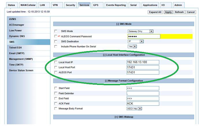

Displaying Incoming SMS Messages on ACEmanager
ACEmanager shows incoming messages on the screen when you are using an SMS mode other than “Password Only”. We suggest to set the device in ACEmanager > Services > SMS to “Control Only”. In the screen shot below, the device shows the last incoming message and the sender’s phone number. This is useful to determine whether or not your mobile network operator sends messages with the leading “1” in front of the phone number.
By default, trusted phone numbers have access and non-trusted phone numbers do not.
