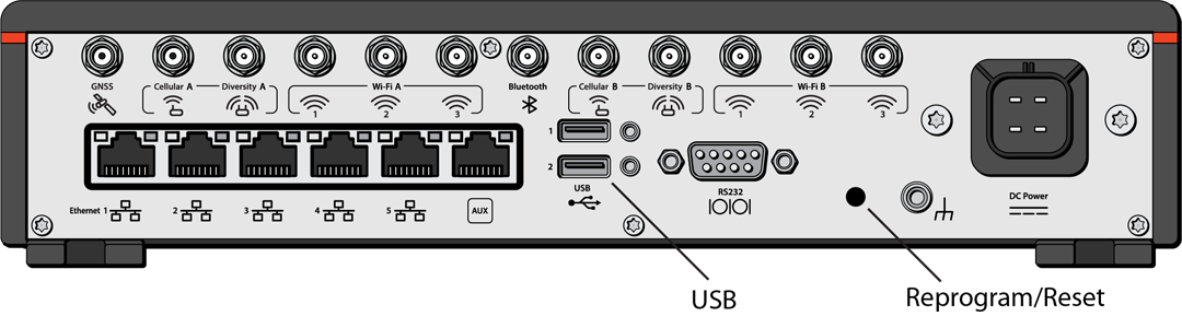

- Insert the USB flash drive into either USB port in the center of the back panel.
- Press and hold the Reprogram/Reset button (you should feel or hear it click).
- While still pressing Reprogram/Reset, apply power to the MG90 (e.g. reconnect the power cable) and wait until the Power LED begins to blink green.
