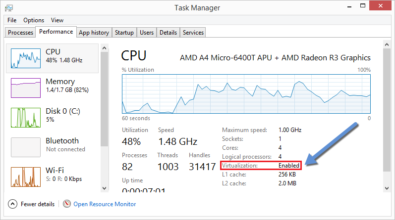

Hardware Assisted Virtualization (BIOS)
Docker VM used by Developer Studio needs Hardware Assisted Virtualization option to be enabled in the BIOS.
In order to check if this option is enabled:
If the option is not enabled, please follow these steps:
  • Restart your computer and go to the BIOS (by hitting some function key, depending on your computer manufacturer)
  • Locate an enable the Hardware Assisted Virtualization option.
    Depending on the manufacturer and on your CPU, it may be called Intel VT-x, AMD-V, Virtualization Technology, or other names.
  • Save and boot your computer normally.

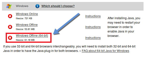

Java 8 64 bit
Java 8 64 bit is necessary to run Developer Studio.
You can verify your Java version by opening a terminal (use Windows Key + R, then type "cmd"), and enter the following command:
java -version
Java version should be explicitly displayed, and you return:
java version "1.8.0_91"
Java(TM) SE Runtime Environment (build 1.8.0_91-b14)
Java HotSpot(TM) 64-Bit Server VM (build 25.91-b14, mixed mode)
If not, it can be installed from java.com (installer ~60MB)
Please make sure to use the Windows Offline (64 bits) installer
