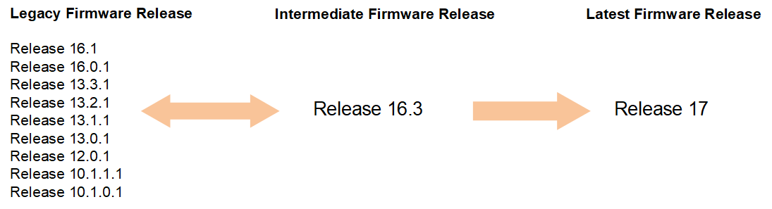

Important note for the 2-stage AV FOTA firmware upgrade:
  • All legacy firmware releases can only be upgraded by AV FOTA to Firmware Release 17 via Firmware 16.3. The AV FOTA process to intermediate Firmware Release 16.3 must firstly be completed before proceeding to the AV FOTA process of upgrading to Firmware Release 17.
  • No firmware downgrade back to prior firmware releases is allowed once the firmware is upgraded to Release 17.
