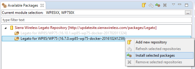

2. Navigate in the list of Available Packages in the left windows, Select the version you need and Install it by clicking right

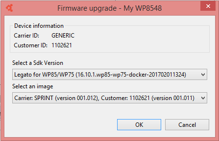

6. Click on  then Select "Flash Firmware..."
7. Select the Legato sdk version and your carrier then click OK to start the download
