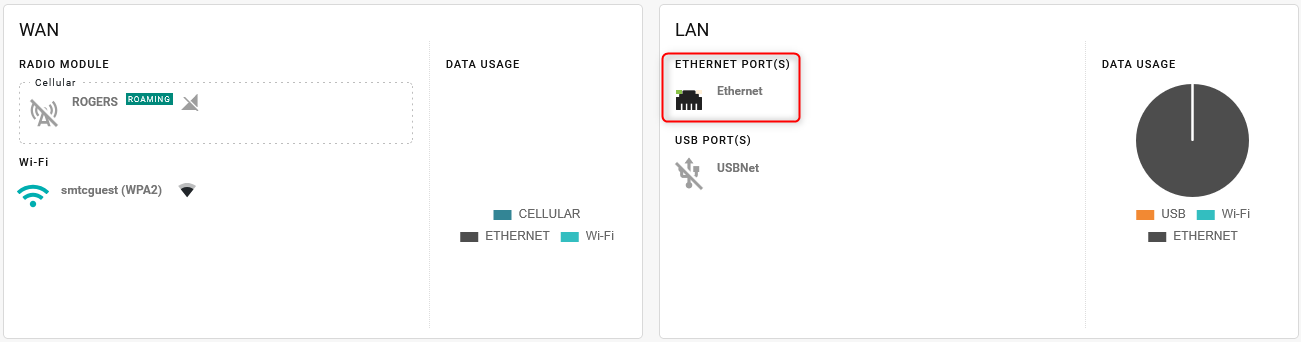

    You can check your Ethernet port configuration under Status > Dashboard.
    For more detail, click on an Ethernet Port entry on the dashboard, and it will automatically take you to the Hardware Interfaces > Ethernet Interfaces > Configuration section.

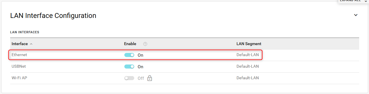

    • Hardware Interfaces > General > LAN Interface Configuration, where you can:
      • View a summary of LAN-configured Ethernet interface(s)
      • Enable or disable the interface(s)
