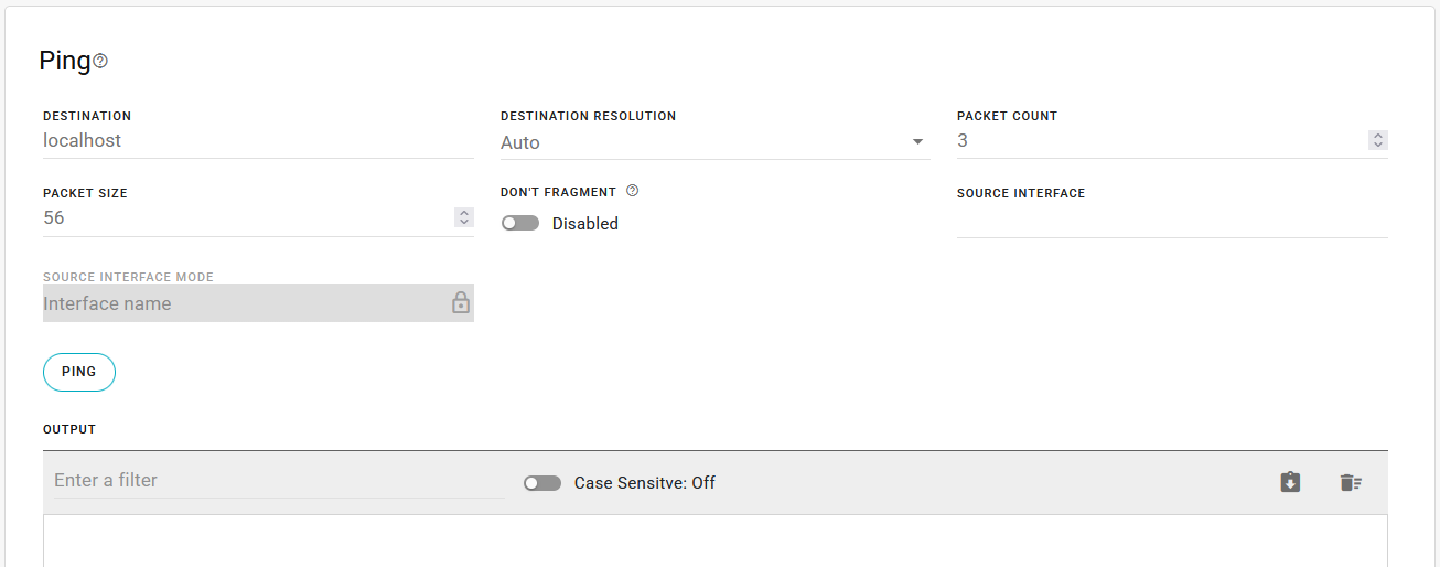

    Ping (Connectivity test)
    The Ping tool (“ping”) tests whether a target device is reachable and indicates the round-trip time to send/receive data packets.
    To use the Ping tool:
    1. Configure the following fields in any order:
      • DESTINATION — Enter the target device address in IPv4 or IPv6 format, or as a host name.
      • DESTINATION RESOLUTION — Enter the DESTINATION’s IP address type (i.e., the DNS ‘resolution’ type):
        • Auto — The router uses the default IP address type and then, if the DESTINATION is a hostname, uses the IPv4 or IPv6 address returned by the DNS.
        • IPv4
        • IPv6
      • PACKET COUNT — Enter the number of packets to send for the test (1-100).
      • PACKET SIZE — Enter the number of data bytes to send for each packet. (1-65507 bytes; default = 56)
      • DON’T FRAGMENT — Control whether the system can fragment (break up) packets into smaller pieces for transmission. Disable this option to transmit fragmented packets, or enable it to transmit complete packets.
      • SOURCE INTERFACE — If required, select the outgoing WAN interface or LAN Segment to use for the ping test. When left blank, the router attempts to reach the destination using any enabled interface according to the routing rules.
      • SOURCE INTERFACE MODE — When SOURCE INTERFACE is set to a LAN Segment, select the mode:
        • Interface name (default): The ping uses the source interface name and is sent from the specified interface regardless of routing. Interface name is recommended for testing the router’s cellular connection or Wi-Fi connection. When a WAN interface is selected for the SOURCE INTERFACE, Interface name is the only option.
        • IP address: The ping uses the source LAN segment’s IP address and follows the routing rules for the configured destination. If the LAN segment’s IP address is missing, the Interface name is used. IP address is recommended for testing routing rules when multiple LAN segments are configured, and when pinging Multi-WAN and Internet destinations.
    2. Click PING .
      The test command and response appears in the output box.
    3. After the response appears in the output box (for one or more ping tests), you can:
      • Search for a specific string in the output — Enter the string in the FILTER field and, if needed, select CASE SENSITIVE to show exact matches.
      • Download the contents of the output box to a local file — Click OUTPUT .
      • Clear the output box — Click the clear output icon ( ).
