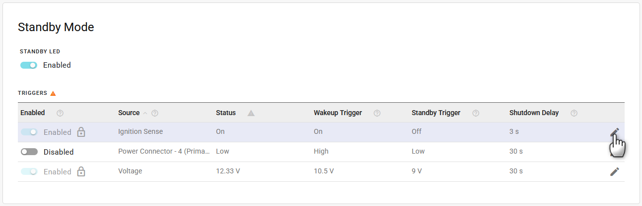

    5. Under System > Power Management > Standby Mode, configure the Ignition Sense Shutdown Delay to be at least 30 seconds.
      • In the TRIGGERS table, click Edit ( ) on the row for Source > Ignition Sense.
      • Set the SHUTDOWN DELAY to at least 30 seconds.
      • Click UPDATE.
