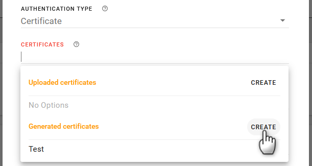

    AUTHENTICATION TYPE Sets the authentication type/method Certificate Certificate, PSK
    CERTIFICATES
    When AUTHENTICATION TYPE is Certificate, lets you select or create PEM certificates or generated certificates for authentication.
    If the certificate is not present:
    • For Uploaded certificates, clicking CREATE will open the Create PEM Certificates screen, where you can upload a new certificate.
    • For Generated certificates, clicking CREATE will open the Create Certificate Signing Request screen, where you can enter a certificate signing request to be sent to your certificate management system. See Managing Security Certificates for more information.

    5. Select the AUTHENTICATION TYPE.
      • After selecting Certificates, you must select any existing PEM Certificates on the router, or upload the certificate components to the router.
      • After selecting PSK, you must enter a text string for the pre-shared key.

    7. Select the AUTHENTICATION TYPE.
