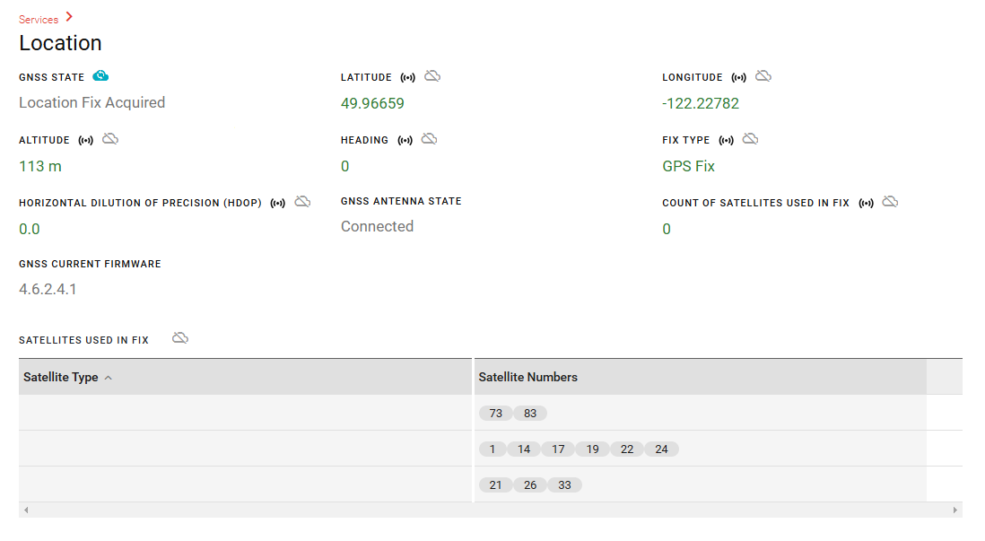

    To view the current GNSS status, go to Status/Monitoring > Services > Location.
    When the router has acquired a GNSS fix, the display will appear similar to the example as shown below.

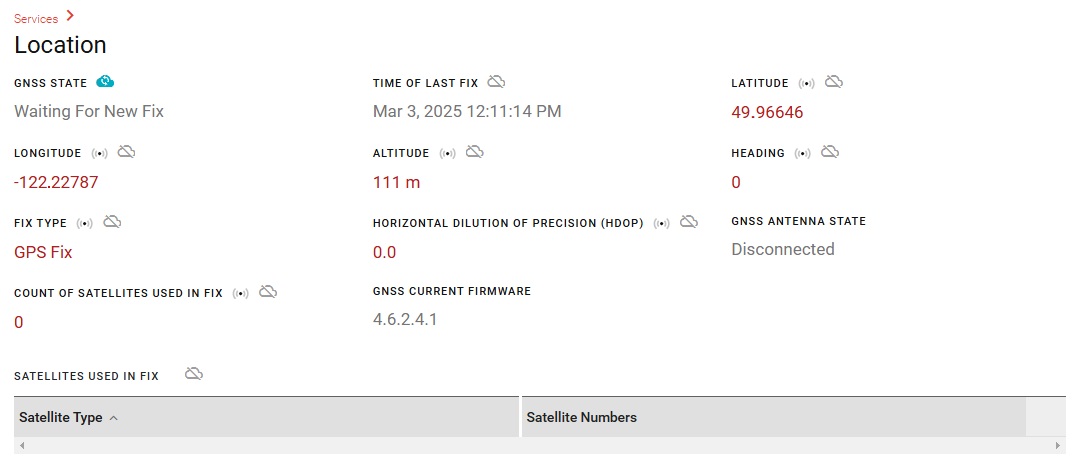

    If the router loses its GNSS fix after previously acquiring a fix, the display will appear similar to the example shown below.
    The values highlighted in red indicate those that have not been updated since the TIME OF LAST FIX.
    The following table describes the values and the possible options.
    VALUE DESCRIPTION OPTIONS
    GNSS STATE Current status of GNSS
    • Starting
    • Device Unavailable
    • Waiting For New Fix
    • Location Fix Acquired
    • Disabled
    TIME OF LAST FIX Timestamp of last known valid GPS location n/a
    LATITUDE Geographic coordinate that specifies location’s position north or south of the Equator. n/a
    LONGITUDE Geographic coordinate that specifies location’s position east or west of the Prime Meridian. n/a
    ALTITUDE Height above sea level n/a
    HEADING Direction in which router is moving n/a
    FIX TYPE Current status of navigation system’s position solution based on available satellite and sensor data.
    • No Fix (location currently not determined)
    • GPS Fix (GPS Fix)
    • DGPS Fix (Differential GPS Fix)
    HORIZONTAL DILUTION OF PRECISION (HDOP) Measure of accuracy of GPS positioning in the horizontal plane (latitude and longitude). Lower HDOP value indicates better positioning accuracy. n/a
    GNSS ANTENNA STATE Current connection status of the antenna used to receive signals from GNSS
    • Disconnected
    • Connected
    • Short
    • Not Available
    COUNT OF SATELLITES USED IN FIX Number of satellites used to calculate the current position fix n/a
    GNSS CURRRENT FIRMWARE Current version of firmware on the router’s GNSS (Global Navigation Satellite System) module n/a
    Once a fix has been obtained, a table appears, showing the satellites used.
