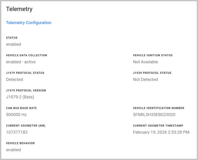

    Telemetry Status
    To view the status of your telemetry configuration, go to Status > Services > Telemetry.
    This section provides some additional data regarding the CAN bus, such as the SAE Standard/Protocol in use, and the baud rate.
    The data shown here will vary depending on your router model and which telemetry settings are enabled.
    J1939 and J1979 protocols are currently supported. J1979-2 is supported in Beta mode, as shown below. Semtech is investigating support for J1979-3 and VDV 238 protocols.
    Features marked “Beta” are available for early evaluation. While functional, they may be refined based on field feedback before general release. Please send feedback to trialfeedback@sierrawireless.com
