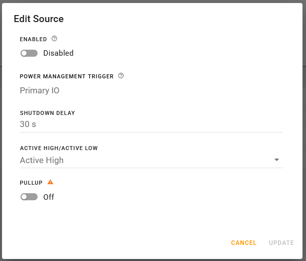

    Primary IO
    To edit an I/O trigger:
    1. Click Edit ( ) in the table on the row for Source > Power Connector 4 (Primary IO).
    2. In Edit Source, enable or disable the Primary IO trigger. The Primary IO trigger is disabled by default.
    3. Select the delay (in seconds) between the I/O state change and the router entering Standby mode. The delay can keep the router powered on during brief state changes in the Primary IO trigger.
      • Range is 2–32767 seconds (default is 30)
    4. Set which logical state of the GPIO makes the router enter or exit standby mode. If set to Active High, the router wakes up and remains on while the GPIO is high and enters standby mode when the GPIO is low. If set to Active Low, the router wakes up and remains on while the GPIO is low and enters standby when the GPIO is high.
    5. Enable/Disable the internal PULLUP on the Primary IO.
      Please note the following:
      • The Primary IO and PULLUP settings can also be configured under I/O > Configuration and I/O > Digital Inputs. Enabling PULLUP on the Edit Source page shown above also enables the Pull Up setting in the I/O > Digital Inputs table.
      • This setting only takes effect when the router is powered on, and not in standby mode.
      • IMPORTANT: When PULLUP is enabled and Active Low is selected, if the I/O line is not connected to ground (floating), the router will never exit standby mode. Ensure your I/O line is grounded, or disable PULLUP for proper operation.
    6. Click UPDATE.
