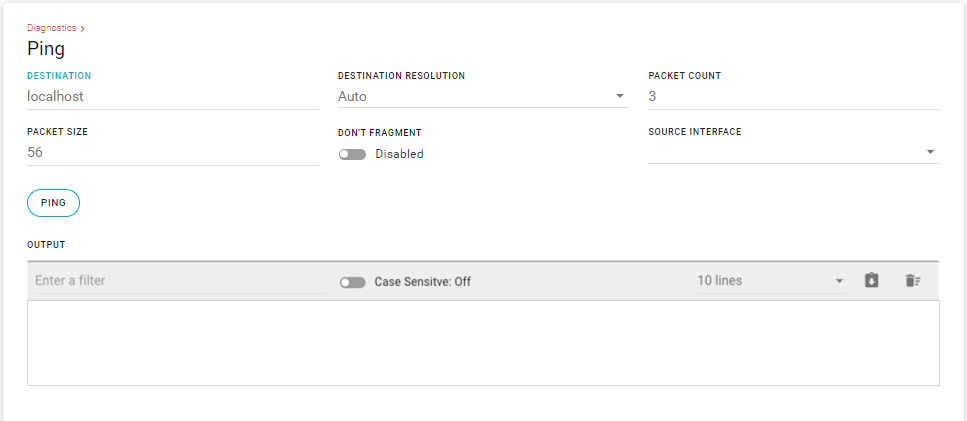

Ping (Connectivity test)
The Ping tool (“ping”) tests whether a target device is reachable and indicates the round-trip time to send/receive data packets.
To use the Ping tool:
Configure the following fields in any order:
DESTINATION — Enter the target device address in IPv4 or IPv6 format, or as a host name.
DESTINATION RESOLUTION — Enter the DESTINATION’s IP address type (i.e., the DNS ‘resolution’ type):
Auto — The router uses the default IP address type and then, if the DESTINATION is a hostname, uses the IPv4 or IPv6 address returned by the DNS.
IPv4
IPv6
PACKET COUNT — Enter the number of packets to send for the test (1-100).
PACKET SIZE — Enter the number of data bytes to send for each packet. (1-65507 bytes; default = 56)
DON’T FRAGMENT — Control whether the system can fragment (break up) packets into smaller pieces for transmission. Disable this option to transmit fragmented packets, or enable it to transmit complete packets.
SOURCE INTERFACE — Select the WAN interface or LAN Segment to use for the ping test. (The default interface is determined by the routing table.)
If the only available WAN interface is the LPWA interface, then the range of addresses that may be accessed can vary from region to region. Customers should only use the Network Diagnostic tools for the LPWA interface under the direct guidance of Semtech support.

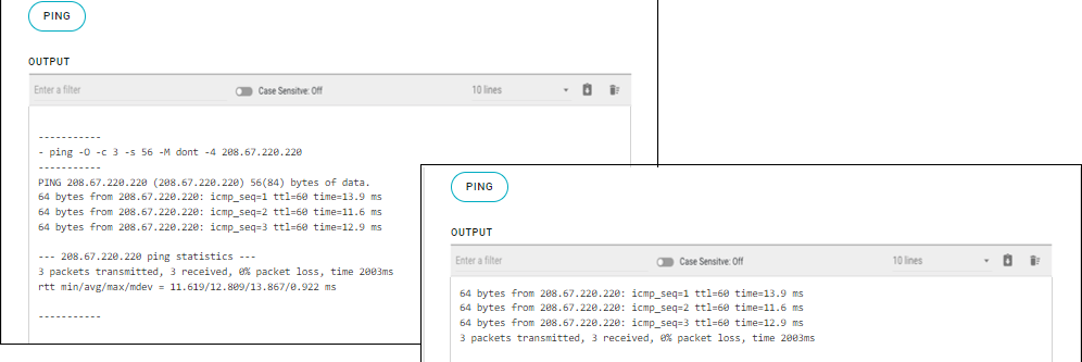

Click PING
. The test command and response appears in the output box.
After the response appears in the output box (for one or more ping tests), you can:
Search for a specific string in the output — Enter the string in the FILTER field and, if needed, select CASE SENSITIVE to show exact matches.
Download the contents of the output box to a local file — Click DOWNLOAD
Clear the output box — Click the clear output icon

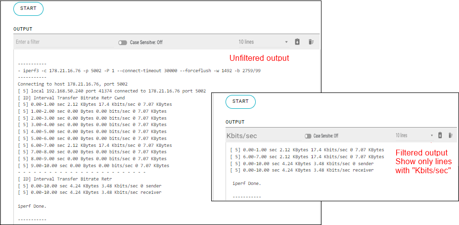

Click START
. The button changes to STOP and the test details appear in the output box.
Wait for the test to complete or click STOP
You can now:

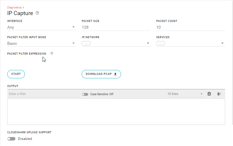

IP Capture (Network traffic test)
The IP Capture tool (“tcpdump”) captures network traffic going through the router.
To use the IP Capture tool:
INTERFACE — Select the WAN interface or LAN Segment to use for the IP Capture test. Note:
Captures on a specific interface are done in promiscuous mode.
If “Any” is selected, packets are captured in non-promiscous mode from all interfaces.
PACKET SIZE — Enter the data packet size
PACKET COUNT — Enter the number of packets to send for the test (1-1000000).
PACKET FILTER INPUT MODE — Select a method for bulding a packet filter for the captured traffic:
Basic — Filter the captured log using the following fields that appear when ‘Basic’ is selected (Note that when the test starts in step 3 below, the PACKET FILTER EXPRESSION is built automatically based on these fields.):
IP/NETWORK — Include traffic only from selected IP/Networks, Reserved IP/Networks, or System IP/Networks. Note:
IP/Networks are user-defined when creating firewall rules
Reserved IP/Networks are user-defined when setting up DHCP reservations
System IP/Networks are provided by the system in the device firmware
SERVICES — Include traffic only using selected Services (communication protocols, e.g., TCP, UDP, etc.) or System Services (e.g., ALMS, ICMP, etc.).
Advanced — Build your own packet filter (using any tcpdump parameters). Enter the filter in the PACKET FILTER EXPRESSION field that appears when ‘Advanced’ is selected.
If you have registered for a Cloudshark account to perform packet analysis, enable CLOUDSHARK UPLOAD SUPPORT to automatically upload captured traffic to Cloudshark for analysis. Enter the cloudshark URL and API token for your Cloudshark account.
Click START
. The test details appear in the output box.
After details appear in the output box (for one or more iperf tests), you can:
Download the captured traffic — Click DOWNLOAD PCAP
