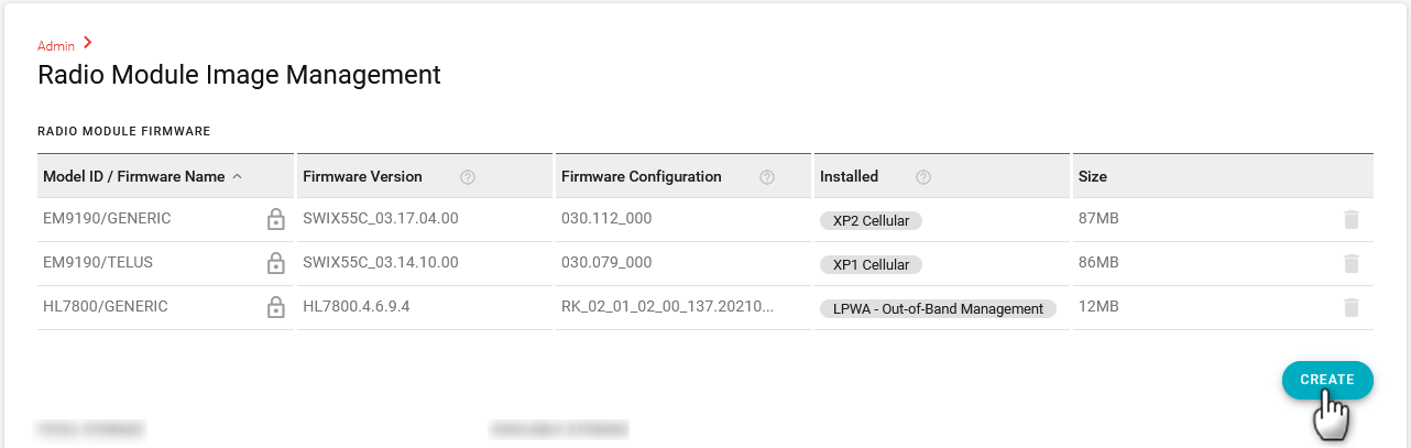

    5. Go to System > Admin > Radio Module Image Management.
    6. Check if the required RMFW is showing in the Radio Module Firmware list.
      • If the firmware is showing and the FIRMWARE VERSION is filled in, then it will automatically switch to the correct RMFW when SIM switching.
      • If the firmware is showing, but the FIRMWARE VERSION is blank, then continue with step 7.
      • If the required firmware is not shown, then you must load it manually on the router. See Manually Loading the Radio Module Firmware Image.

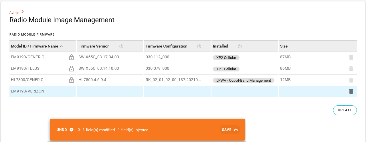

    If the RMFW does not already exist on the router, then use the following process to manually download the RMFW from ALMS onto the router.
    1. Click CREATE.

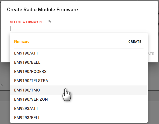

    2. Click on the entry line to select the desired module/carrier combination from the list.

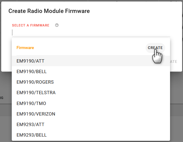

      If you don’t find your desired radio module/carrier combination in the list:
        a. Click on the entry line and click CREATE.
        b. Enter the new firmware name (Model ID / Firmware Name)
        c. Click CREATE to create an instance with this value.
    3. Click CREATE to add a radio module firmware entry in the table.
    4. Click SAVE and a new row for the selected carrier appears. The FIRMWARE CONFIGURATION and FIRMWARE VERSION fields are blank.
    5. Reboot the router, which will perform an Airlink OS update that will retrieve the RMFW and add it to the router. After reboot, the router executes several checks and the RMFW image switch occurs based on the SIM that was inserted, as indicated by the green LED chase pattern. The update should take 2–5 minutes, depending on the RMFW version it is updating to.
    When the update is complete, you can confirm the RMFW configuration under Status / Monitoring > Cellular. Check that the FIRMWARE NAME, FIRMWARE VERSION, and FIRMWARE CONFIGURATION have been updated.

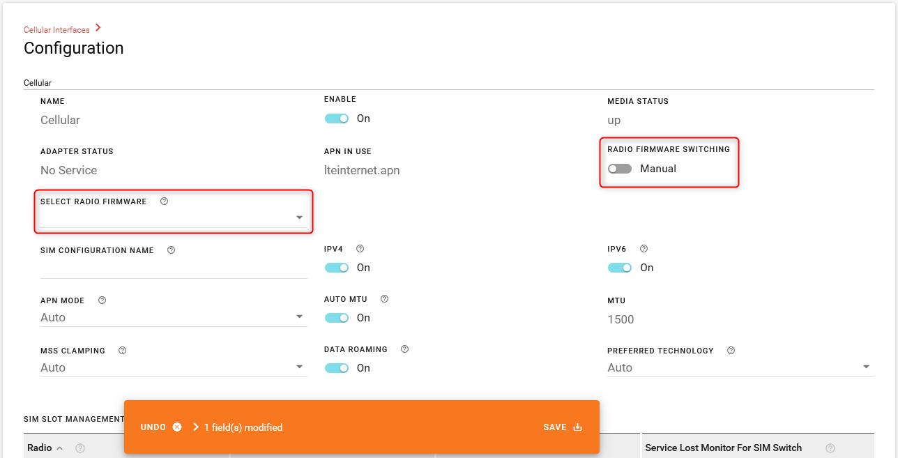

    Optional: Manual Radio Module Firmware Image Switching
    When RADIO FIRMWARE SWITCHING setting is set to Manual, you can manually switch the radio module firmware to a specific network operator using this process. You can check the RADIO FIRMWARE SWITCHING setting in the Hardware Interfaces > Cellular Interfaces > Configuration section.
    As a prerequisite, the RMFW image must be loaded on the router. See Manually Loading the RMFW Image.
    Follow the process below to manually switch the radio module firemware.
    1. Ensure the router is powered off.
    2. Insert the carrier SIM that you want to image switch to into the desired SIM Card (slot).
      • By default on the XR90, SIM Card (slot) 1 maps to XP1 and slot 2 maps to XP2.
    3. Power the router on.
    4. Go to Hardware Interfaces > Cellular Interfaces > Configuration.
    5. Under RADIO FIRMWARE SWITCHING, click Automatic to switch it to Manual.
    6. Under SELECT RADIO FIRMWARE, select your desired carrier.
    7. Click SAVE.
    The Cellular ADAPTER STATUS indicates Initializing and then Updating Firmware within a few seconds, as indicated by the green LED chase pattern. The update should take 2–5 minutes depending on the RMFW version it is updating to.
    When the update is complete, you can confirm the RMFW configuration under Status/Monitoring > System > Cellular. Check that the FIRMWARE NAME, FIRMWARE VERSION, and FIRMWARE CONFIGURATION have been updated.
