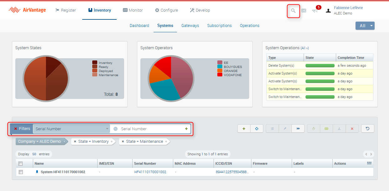

    I cannot find my system
    On the start page the following widget displays the number of systems that are pending activation.
    Click on the Activation link to list all Systems ready to be activated within your company.
    You can then use the filtering capabilities to find your system given its Serial Number or other criteria.
    If the system is not in the list, you can either jump to the Monitor activity to check among the already activated systems, or as an alternative use the company wide search capability represented by the loop icon on the top banner.
    If you still cannot find it, then please contact your reseller

    To check whether a specific system is activated, you can go to the Inventory activity and System sub-menu. You can then use the filtering capabilities to find your system given its Serial Number or other criteria. If the icon next to your system name is the one representing Inventory: , it means that your system is not activated yet.
