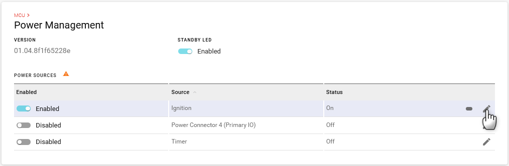

    4. Under MCU > Power Management, configure the ignition SHUTDOWN DELAY to be at least 30 seconds.
      • In the POWER SOURCES table, click Edit ( ) on the row for Source > Ignition.

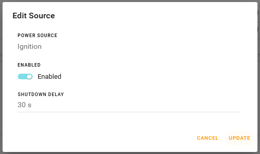

      • Set the SHUTDOWN DELAY to at least 30 seconds.
      • Click UPDATE.
