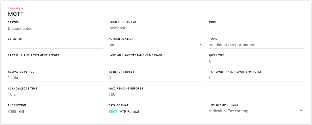

    REPORT MODE
    Destination of where reports will be sent to. The MQTT configuration will only display if the REPORT MODE is set to an MQTT option. Options are
    • ALMS
    • MQTT
    • ALMS and MQTT
    MQTT TOPIC REPORT NAME Name of the report that will be included in the MQTT TOPIC.

    MQTT
    The MQTT section will only display if a custom report or a vehicle behavior report has the REPORT MODE set to an MQTT option.
    A destination MQTT broker can be configured using the following settings.
    SETTING DESCRIPTION OPTIONS DEFAULT
    BROKER HOSTNAME Hostname of MQTT broker IPV4 localhost
    PORT Port that the MQTT broker is listening for incoming connections Default port normally used is 1883. See your MQTT broker administrator. N/A
    CLIENT ID Unique vehicle id
    N/A
    AUTHENTICATION Authentication information used to connect to MQTT broker
    • None
    • Username and Password
    None
    TOPIC
    Used to identify the subject of a message.
    For example, when the MQTT Topic Report Name is configured as test and the TOPIC is as default, then on the subscriber end, the following is received:
    6Q1099009902AC24/test {
      “atp.ser” :
            “t”: 1693258321.3640001,
            “v” : “6Q1099009902AC24”
            “ts” : 1693268920.464
    <serialno>,<usbmac>,<ethernetmac>,<clientid>,<reportname>, or user defined. <serialno>/<reportname>
    LAST WILL AND TESTAMENT REPORT This feature is not implemented at this time.
    LAST WILL AND TESTAMENT MESSAGE This feature is not implemented at this time.
    QOS LEVEL Quality of Service level
    0 : At most one-time delivery. Your data can be lost. No retransmission outside of TCP.
    1 : At least one-time delivery. Your data will be retransmitted if needed. The message can be received more than once.
    2 : Exactly one-time delivery. The message will be delivered exactly once but the communication overhead is high (multiple acknowledgement messages).
    0
    KEEPALIVE PERIOD Maximum time that can elapse between two messages 0 to 3600 s 1 MIN
    TX REPORT BURST Maximum number of reports to send before rate limiting 0 to 1000 0
    TX REPORT RATE [REPORTS/MINUTE] Maximum number of reports to send per minute 0 to 6000 0
    ACKNOWLEDGE TIME Time to wait for acknowledgement 1 to 600 s 10 s
    MAX PENDING REPORTS Maximum number of pending reports before it will start to purge the oldest 100 to 100000 100
    ENCRYPTION This feature is not implemented at this time.
    CERTIFICATE This feature is not implemented at this time.
    DATA FORMAT Format of data sent to MQTT broker.
    • ATP FORMAT - ATP FORMAT will use an atp prefix on the data sent to the MQTT broker, for example : atp.GLON
    • NON-ATP FORMAT : uses least amount of data over the air, for example : GLON
    ATP FORMAT
    TIMESTAMP FORMAT Format of timestamp used in report sent to MQTT broker.
    • Individual Timestamp - Timestamp of each sample collected.
    • Report Timestamp - Timestamp of when the report is generated. Least amount of data used.
    • Report and Individual Timestamp
    More information about MQTT can be found here.
