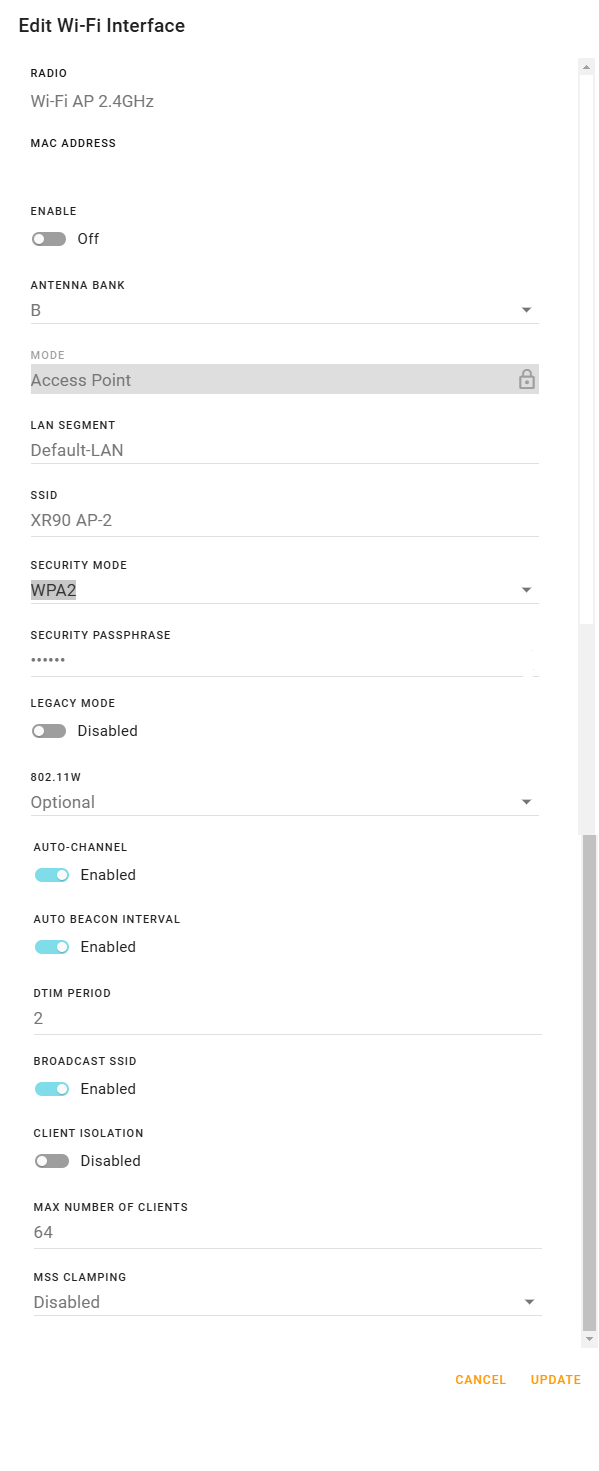

    Configuring a Wi-Fi Access Point
    To configure an interface as an Access Point, click at the end of an Access Point interface row in the WI-FI INTERFACES table (as shown above).
    The Edit Wi-Fi Interface menu appears — configure the fields in any order.
    • ENABLE the interface, and leave the MODE as Access Point.
    • If an ANTENNA BANK choice is shown, select the bank that is most suitable for your client devices:
      • A — Wi-Fi A
      • B — Wi-Fi B
    • Select the LAN SEGMENT that you’re going to use for this access point.
      Tip: Click X to display the list of available LAN segments. LAN segments are configured under Networking > Zones Settings > LAN Segments.
      Best Practice recommendation: If the 2.4GHz and 5GHz AP(s) are configured on different LAN segments, use different SSIDs and security passphrases to make sure DHCP renews IP adresses when switching between the APs.
    • Enter the access point’s SSID (a case-sensitive network name).
    • Select the SECURITY MODE — Depending on the mode selected, specific security credential types are required:
      • OPEN — No security. (This mode is not recommended.)
      • WPA — Requires only a SECURITY PASSPHRASE (This mode is not recommended and will only be seen if the LEGACY MODE is enabled.)
      • WPA2 — Requires a SECURITY PASSPHRASE, plus 802.11w options.
      • WPA2/WPA3 Transition Mode — Requires a SECURITY PASSPHRASE, plus automatically sets 802.11w internally as Optional.
      • WPA3 — Requires only a SECURITY PASSPHRASE, plus automatically sets 802.11w internally as Required.
      • WPA2-Enterprise — Requires RADIUS Authentication & Acceptance server details.
    • For all security modes except OPEN and WPA2-Enterprise, enter a SECURITY PASSPHRASE of at least 8 characters.
    • For WPA2-Enterprise security mode only:
      • Select the RADIUS AUTHENTICATION SERVER to use. This is the primary RADIUS server and is required. If there are no servers in the list, select CREATE and enter the following:
        • LABEL — name of the server
        • SERVER — IPv4 address of the server
        • PORT — optional. The port that is used to connect to the server. Default is 1812.
        • CLIENT IP — optional. RADIUS client IPv4 address. The router will use this as IP source address when making RADIUS requests. Use this setting if a RADIUS server or VPN tunnel requires a specific source IP for the RADIUS client.
        • TIMEOUT — Not applicable for primary RADIUS server. For the secondary RADIUS server, it indicates the timeout for switching back to the primary RADIUS server after failover.
        • SECRET — the shared secret used for encryption when a client connected to the device’s AP is connecting to the RADIUS authentication server
      • Optionally select the RADIUS AUTHENTICATION SERVER 2 to specify the backup RADIUS server. Select from the list, or select CREATE.
      • Optionally select the RADIUS ACCOUNTING SERVER to use. Select from the list, or select CREATE.
    Note:
    • RADIUS servers must use IPv4 addresses. FQDNs and IPv6 addresses are not supported.
    • RADIUS servers can also be created by going to System > User Accounts > RADIUS.
    • As an access point (AP), the router does not establish a direct connection to the RADIUS server. Instead, it relays authentication requests from the client to the server for processing.
    • Enable LEGACY MODE to restore security option WPA (version 1) and support TKIP encryption for WPA/WPA2 modes. By default, this is disabled and only AES encryption is supported.
      Note: TKIP is only supported in non-US regions even with LEGACY MODE enabled.
    • For WPA2-Enterprise security modes only, select the 802.11W option.
      The 802.11w standard uses Protected Management Frames (PMF) to ensure clients are legitimate. Options are:
      • Disabled
      • Optional (default) — 802.11w is used for clients that support it, while clients that do not support 802.11w will still connect to the router.
      • Required — Forces 802.11w operation; clients that do not support 802.11w will not connect.
    • Enable AUTO CHANNEL to have the router choose the channel on which to operate.
      To use a specific channel, disable AUTO CHANNEL and then select it from the CHANNEL list that appears.
    • Enable AUTO BEACON INTERVAL to have the router send periodic messages (beacons) to advertise its availability. To choose a specific interval, disable AUTO BEACON INTERVAL and then manually enter the required BEACON INTERVAL in milliseconds (100 ms is the default).
    • Set the DTIM PERIOD to the number of beacons (plus 1) that a client device can sleep through before waking to check for messages.
      For example, if the DTIM Period is set to 3, the client sleeps through two beacons and wakes for the third beacon. The higher the DTIM PERIOD value, the longer the client device can sleep, and the more battery power the client device can potentially save. However, high DTIM periods can also reduce throughput to the client. The default period is 2 (wake for every second beacon).
    • Enable BROADCAST SSID to have the router make the SSID visible to client devices. If BROADCAST SSID is disabled, the SSID is not shown to other devices, and the SSID and passphrase must be entered on the client for a client to connect.
    • When CLIENT ISOLATION is disabled (the default setting), clients can “see” each other, and potentially sniff traffic from each other.
      • For passenger Wi-Fi applications, enable client isolation to enhance security.
      • Disable client isolation if you have client applications on the same LAN segment that need to interact with each other.
    • Set the MAX NUMBER OF CLIENTS — Enter the maximum number of clients that can connect simultaneously to this access point interface. As a guideline, set a limit that is slightly higher than the number of clients you expect to connect.
      The maximum value you can enter depends on the interface:
      • Wi-Fi A 5GHz in AP mode supports up to 128 clients (includes clients connected to up to two additional 5GHz SSIDs)
      • Wi-Fi AP 2.4GHz supports up to 64 clients (includes clients connected to up to two additional 2.4GHz SSIDs)
      • Wi-Fi B 5GHz in AP mode supports 64 clients (includes clients connected to up to two additional 5GHz SSIDs)
      For example (using the Wi-Fi A 5GHz radio in the figure below, which is capable of supporting up to 128 clients):
      Configured Maximum Total Allowed Wi-Fi A 5GHz connected Wi-Fi A 5GHz SSID 1 connected Wi-Fi A 5GHz SSID 2 connected Available
      Wi-Fi A 5GHz = 128
      Wi-Fi A 5GHz SSID 1 = 128
      Wi-Fi A 5GHz SSID 2 = 128
      128 50 46 0 32 across all three SSIDs
      Wi-Fi A 5GHz = 30
      Wi-Fi A 5GHz SSID 1 = 20
      Wi-Fi A 5GHz SSID 2 = 10
      60 25 20 5 10 across Wi-Fi A 5GHz and Wi-Fi A 5GHz SSID 2
      (Wi-Fi 5GHz A SSID 1 is at max.)
    • Select the MSS CLAMPING option — MSS (Maximum TCP Segment Size) Clamping controls the maximum packet size used for TCP connections between a local (LAN-side) host and a remote host over the Wi-Fi WAN interface. MSS Clamping helps avoid possible issues with sending and receiving large TCP packets over the WAN interface when other standard MTU mechanisms do not appear to be working with your installation. The options are:
      • Disabled (default)
      • Auto — When set to Auto, the MSS is calculated based on the detected MTU(Maximum Transmission Unit) of the network path as discovered by Path MTU Discovery(PMTUD).
      • Manual — MSS is clamped to the specified maximum value bi-directionally for all inbound (remote-to-LAN) and outbound (LAN-to-remote) TCP connections when the TCP session is established using the Wi-Fi interface.
    • Set MSS — When MSS CLAMPING is set to Manual, set the Maximum TCP Segment Size.
      • Range is 1–2000 bytes (default is 1460)
    Adding Additional SSIDs (Virtual Access Points)
    A USE ADDITIONAL SSIDS switch is below the Wi-Fi configuration table. This switch can be used when you require multiple SSIDs broadcasting on separate LAN segments which are configured for different security protocols.
    When enabled, an Additional SSIDS table opens from which you can select, enable, and edit SSIDs (Virtual Access Points — “VAP”s).
    Up to two additional SSIDs can be enabled for each of the access point interfaces (i.e., two for Wi-Fi A 5GHz, two for Wi-Fi AP 2.4GHz, and two for Wi-Fi B 5GHz).
    To configure an additional SSID, click at the end of the row in the ADDITIONAL SSIDS table (as shown above).
    The Edit Wi-Fi VAP menu appears — configure the fields in any order.
    This menu is identical to the Edit Wi-Fi Interface menu except there are no CHANNEL or BEACON INTERVAL settings. Those settings are inherited from the corresponding Wi-Fi Interface.

    You can complete the Client mode configuration in the WI-FI INTERFACES table.
    To configure an interface as a Client, click at the end of the row of a Client interface.
    • ENABLE the interface, and leave the MODE as Client.
    • Set the SSID SELECTION switch:
      When you have multiple SSIDs configured, Sierra Wireless recommends leaving SSID SELECTION at the default Auto (Highest Priority) setting. The router will automatically search and connect to an SSID depending on priority. If priorities are identical, the router will use the closest SSID with the fastest estimated link speed. To configure the Wi-Fi client to use only a single, specific SSID, set SSID Selection to “Manual” and then choose the CONFIGURED SSID you wish to connect to.
    • Enter the SCAN INTERVAL, which sets how often the router scans for SSIDs when disconnected.
    • Set the BACKGROUND SCAN switch, which enables or disables the router scanning and connecting to higher priority SSIDs while already connected.
    • Enter the BACKGROUND SCAN INTERVAL, which sets how often the router scans for other SSIDs when connected.
