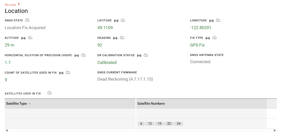

    To view the current GNSS status, go to Status/Monitoring > Services > Location.
    When the router has acquired a GNSS fix, the display will appear similar to the example as shown below.

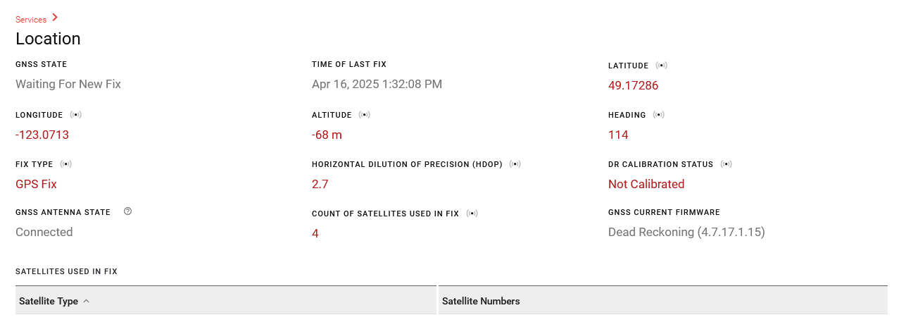

    If the router loses its GNSS fix after previously acquiring a fix, the display will appear similar to the example shown below.
    The values highlighted in red indicate those that have not been updated since the TIME OF LAST FIX.

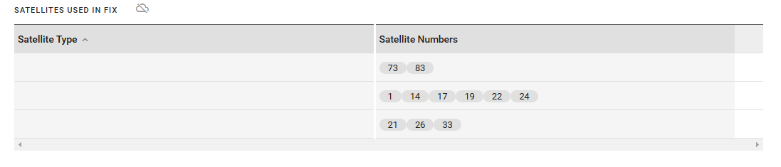

    Once a fix has been obtained, a table appears, showing the satellites used.
