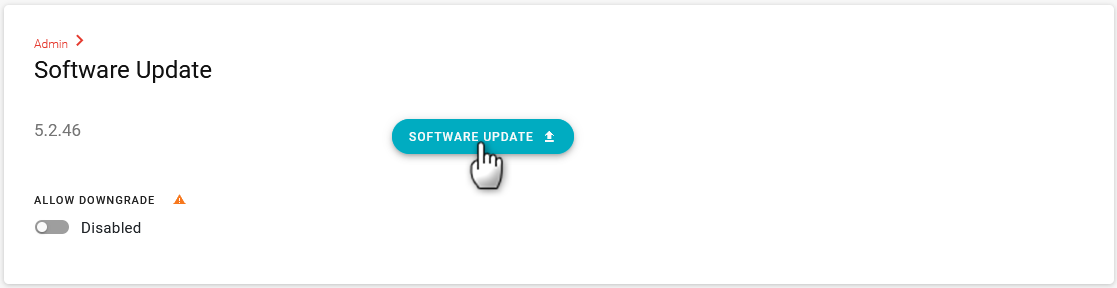

    2. In AirLink OS, go to System > Admin > Software Update.
    3. Click SOFTWARE UPDATE.

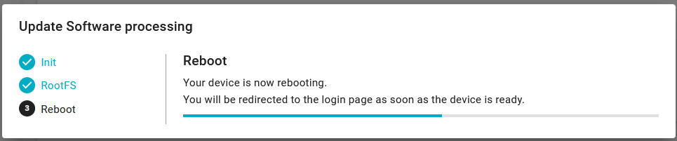

    4. Select the .ufw file and click Open. The progress bar shows each step of the update process, followed by your router rebooting.
      The number of steps may vary depending on the size of the software update.
    Allow Downgrade
    By default, software downgrades are disabled. If you must revert to a previously installed AirLink OS software, you can use SWITCH TO BACKUP IMAGE. See Software Image Management below.
    If you need to downgrade the router to a different AirLink OS release, you can click ALLOW DOWNGRADE to enable the downgrade. You can then click SOFTWARE UPDATE to install a previous AirLink OS release.
    Downgrading software in this way will reset the router to factory defaults.

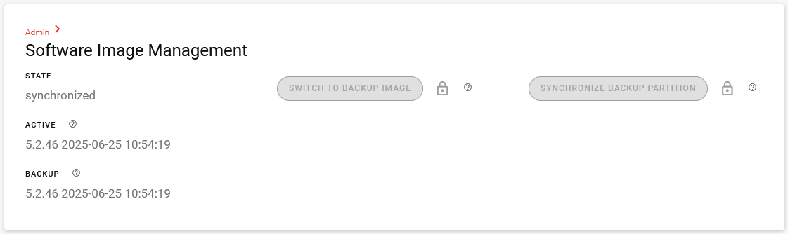

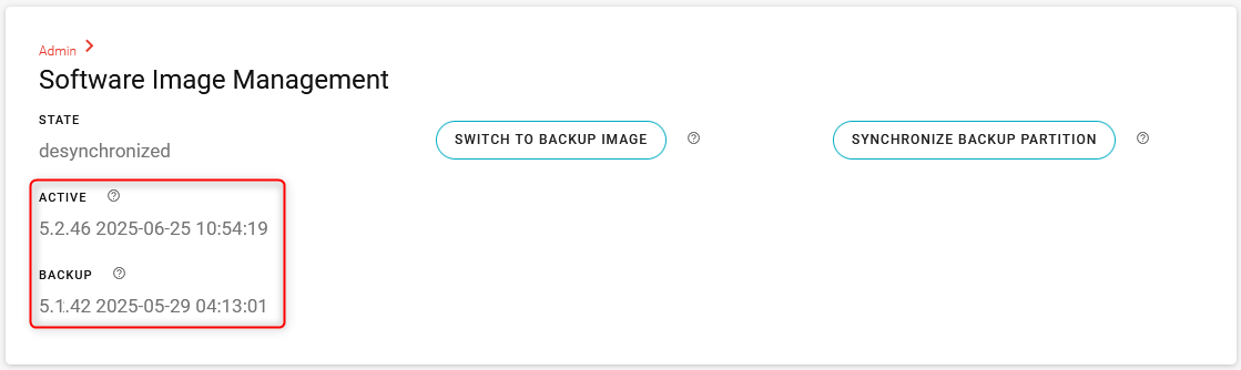

    After a software upgrade, AirLink OS stores the previous software image to use as a backup, along with the corresponding device configuration. In the event that the router switches to the backup image, the stored device configuration is also applied to the router.

    In addition to reverting to the last used software, switching to the backup image reverts any configuration changes made since the last software upgrade.
    To manually switch to the backup image:
    • Click SWITCH TO BACKUP IMAGE.

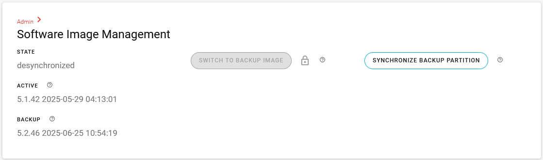

    The router reboots. The backup image is now the active image, and the previous router configuration takes effect.
    The SWITCH TO BACKUP IMAGE button is now disabled because the router is already running the backup image.
    When the router is running the backup image as the active image, you must update the software again if you no longer want the router to use the backup image.

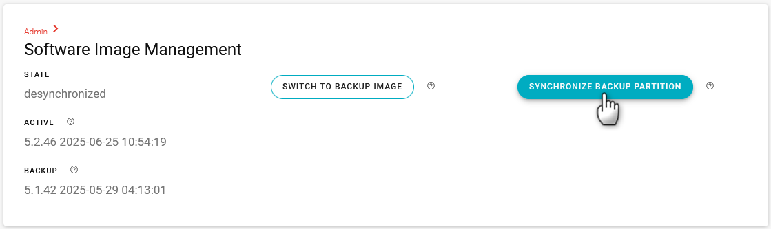

    Synchronize Backup Partition
    The SYNCHRONIZE BACKUP PARTITION feature should be used only if advised by Semtech support. This recommendation may change following a future AirLink OS release.
    Clicking SYNCHRONIZE BACKUP PARTITION overwrites the previous backup image with the active image. Image switching is disabled (as shown below) until you update the software to a different version.
    The SYNCHRONIZE BACKUP PARTITION process also deletes the router configuration that was stored with the previous backup image, and does not store the current configuration with the new backup image. The router configuration is stored along with the backup image only when a software upgrade occurs.
