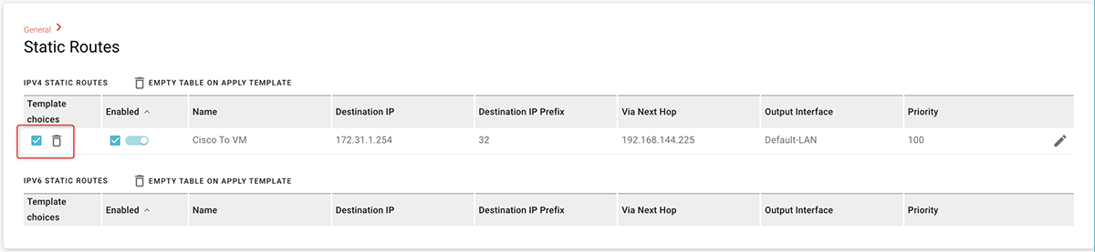

Click Continue. The AirLink OS interface opens in Template Mode.
To add a setting from the template, select the checkbox for the setting. The setting and its current value will be added to the template.
To delete a setting from the template, clear the checkbox for the setting.
