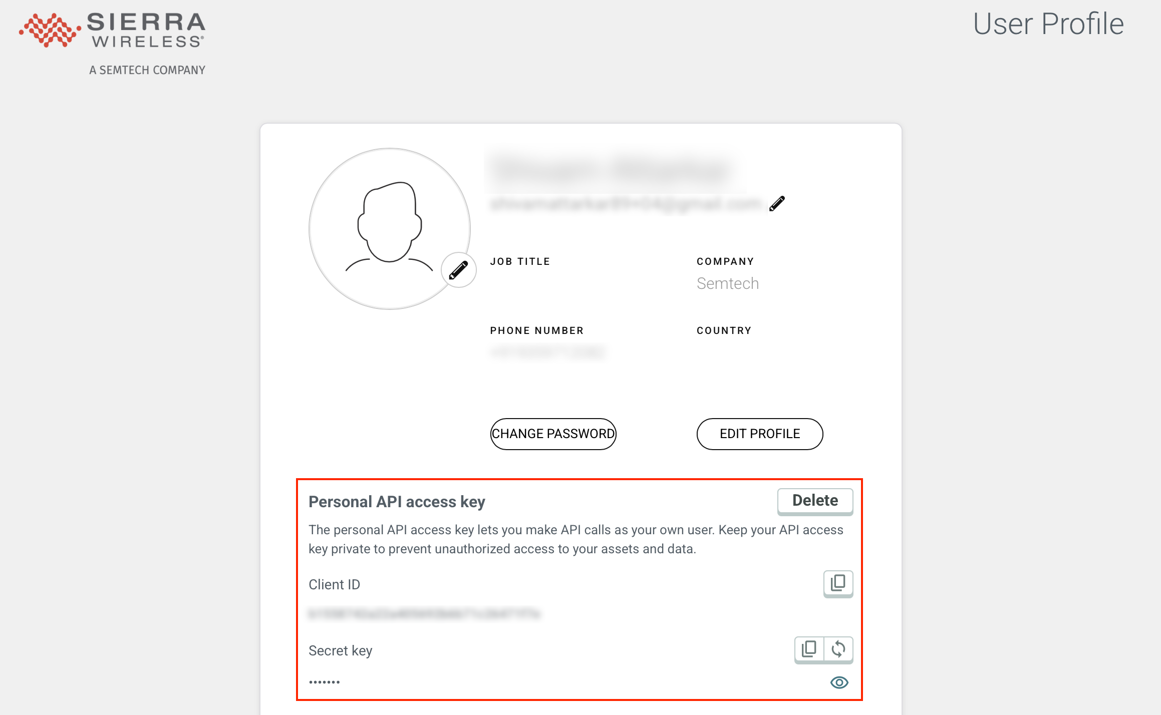

    All personal API access key operations are managed from your User Profile. To access this section:

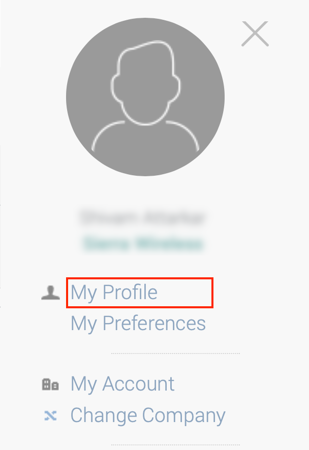

    1. Click the Menu icon Menu Icon in the top right corner of the AirVantage interface.
    2. Select My Profile from the righthand side menu.
    3. You will see the Personal API access key section at the bottom of the page.

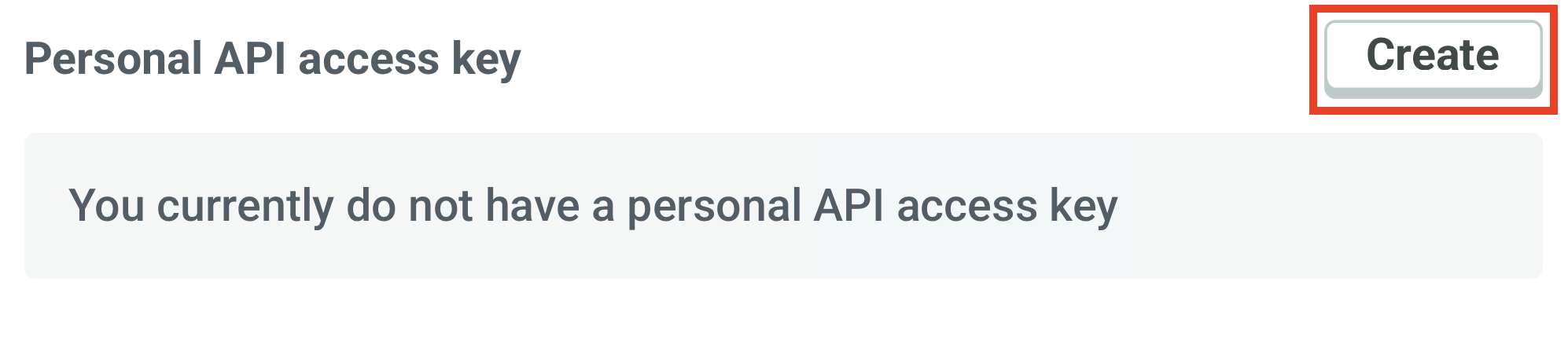

    Creating a new personal API access key
    1. Navigate to your User Profile by following the steps outlined in the Accessing Personal API Section . Initially, you will see a message indicating that you don’t have a personal API access key.
    2. Click Create to generate a new Personal API access key. Once created, your personal API access key will be displayed with your Client ID and Secret key.

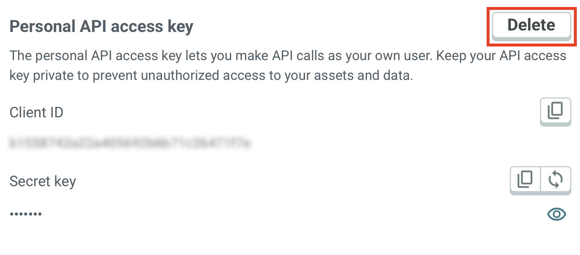

    How to delete a personal API access key
    When you no longer need your personal API access key, you can permanently delete it. This action will immediately revoke access for any applications using this client’s credentials.
    Deleting a personal API access key will immediately revoke access for any applications using this client’s credentials. This action is immediate and cannot be undone.
    2. In the Personal API access key section, click Delete. A prompt will be displayed to confirm whether you want to delete the personal API access key.
    3. Click Confirm to permanently remove the personal API access key.
