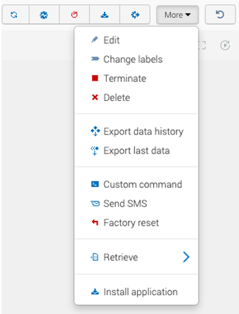

    Device Management actions
    The following actions can be run on the system, depending on the capabilities of the system:
    Synchronize Create a synchronization operation; the server will read all the data known for this system next time the system communicates.
    Configure Communication Change heartbeat and periodic reports.
    Reboot Reboot the system.
    Upgrade Firmware Upgrade the system with new firmware.
    Apply Template Apply an already created template.
    Edit Edit the system details.
    Change labels Add labels to the system or remove labels from the system.
    Activate Activate the system if it is in Maintenance or Inventory.
    Export data history Export a .csv file containing information in AirVantage for a single system.
    Export last data Export a .csv file containing the last known information in AirVantage for multiple systems.
    Custom Command Send a command to a system. Commands must be defined in one of the applications running in your system.
    Send SMS Send a SMS. A SMS account needs to be configured for your company. See How to configure an SMS account? for help.
    Wake Up Send a wakeup SMS. A SMS account needs to be configured for your company. This function is supported only on OpenAT AirPrime module.
    Factory reset Restore the system to its factory settings.
    Retrieve > Device data Retrieve a dataset from the device.
    Retrieve > System logs Retrieve and then download logs from the device. See How to retrieve logs from a system? for help.
    Send AT Command This function is supported only on OpenAT AirPrime modules.
    Install Application Install or upgrade an embedded application on your system.
    Install Bundle For systems that use Legato, install a system bundle on your system. See Create Systems Bundles on the Legato web site for help.
