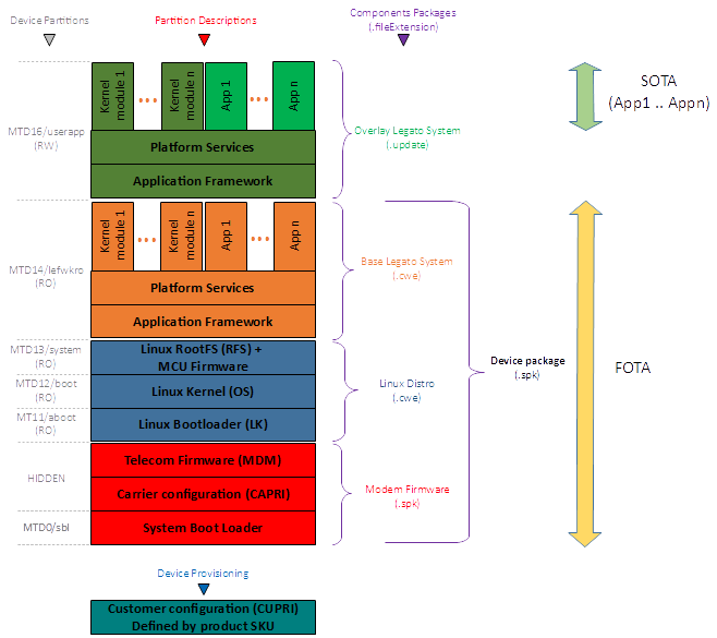

This page describes in detail the components included with the Firmware Release, how to build your own custom device image based on Release 10.1.0.1 components and how to download it on your product.
The Firmware and its components are mapped into the flash as follows:
Release 10.1.0.1 Components
