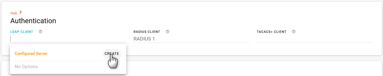

    To configure LDAP:
    1. Go to Web > Authentication > LDAP CLIENT.
    2. Click the blank field, and then click CREATE.
    3. In Create Server, configure the settings described in the table below.
    4. Click CREATE.
    The server you configure here will also appear under System > User Accounts > LDAP.

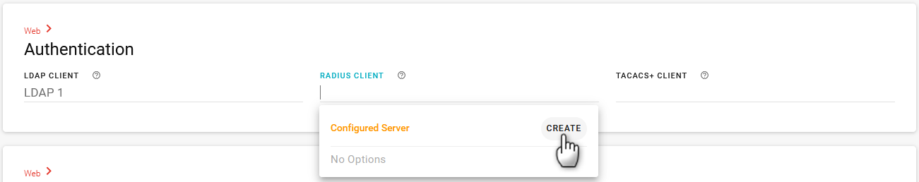

    To configure RADIUS:
    1. Go to Web > Authentication > RADIUS CLIENT.
    4. Click CREATE.
    The server(s) you configure here will also appear under System > User Accounts > RADIUS. The server(s) will also be available to select as primary and backup RADIUS authentication servers for a Wi-Fi access point using WPA2-Enterprise security mode.

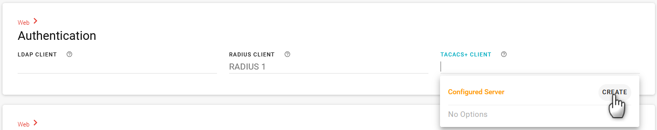

    TACACS+ Client
    This section describes the configuration settings for Terminal Access Controller Access-Control System Plus (TACACS+) that uses the TCP protocol to authenticate users.
    To configure TACACS+:
    1. Go to Web > Authentication > TACACS+ CLIENT.
    4. Click CREATE.

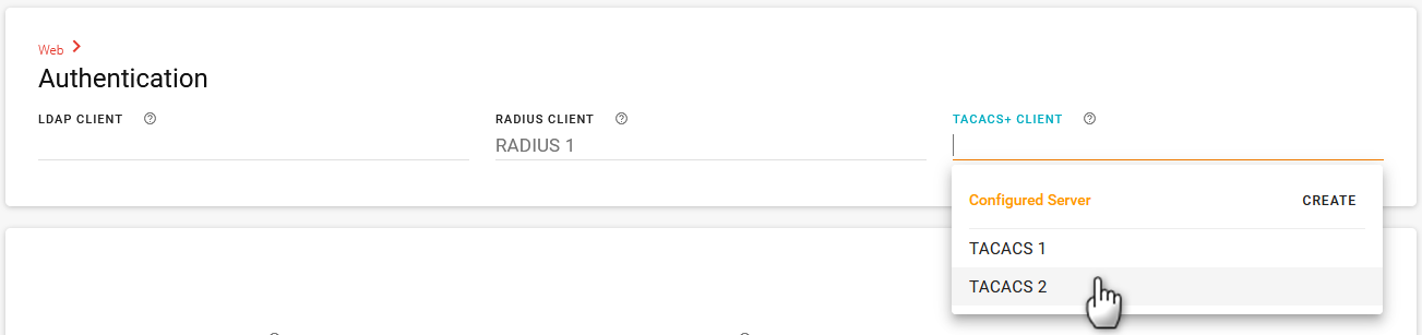

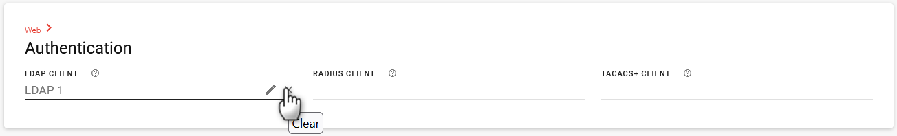

    Editing or Adding Remote Authentication Servers
    After you have configured a remote authentication server, you can click to edit the configuration.
    You can also add another server configuration by clicking (Clear), clicking the empty field, and then clicking CREATE.
    If multiple servers are configured, you can select a different server by clicking (Clear), clicking the empty field, and then selecting the desired server.
    To delete a server, you can click to edit the configuration and then click DELETE at the bottom of the Edit Server page.
