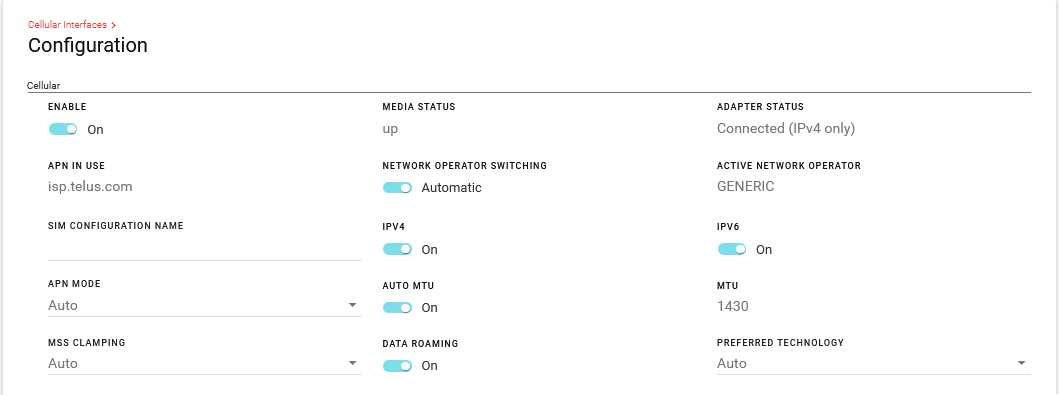

    To configure cellular interfaces, go to Hardware Interfaces > Cellular Interfaces > Configuration.
    Table of Contents
    Cellular Configuration
    Not all the settings shown below appear when the router is operating without a SIM card installed.
    • ENABLE
    • MEDIA STATUS: Status of the antenna link connection. This reports whether the antenna is present and a cellular network signal is detected. In some cases, the router may get a cellular network signal even when the antenna is not connected.
    • ADAPTER STATUS: Cellular radio and connectivity status can have the following values.

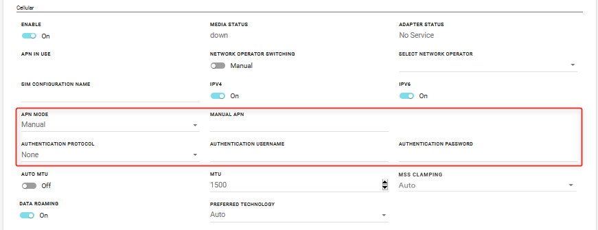

    • APN MODE: Auto, Manual, Multi
    If the router does not automatically connect to the network, contact your Mobile Network Operator to confirm the APN and activation status of your router. You may need to set APN MODE to manual and enter your carrier’s APN and other credentials.
    When APN MODE is set to Manual, you may need to set one or more of the following:
    • MANUAL APN: The carrier network may assign an APN and allow the router to connect without specifying a manual APN.
    • AUTHENTICATION PROTOCOL: If required by your carrier. Options are: None, PAP, CHAP, AUTO
    • AUTHENTICATION USERNAME: If required and provided by your carrier
    • AUTHENTICATION PASSWORD: If required and provided by your carrier

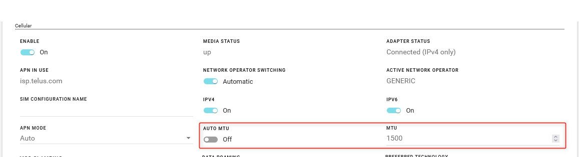

    • AUTO MTU: By default, AUTO MTU is On. You can turn AUTO MTU off and manually configure MTU (Maximum Transmission Unit in bytes) if you have VPN issues, and as directed by your service provider.

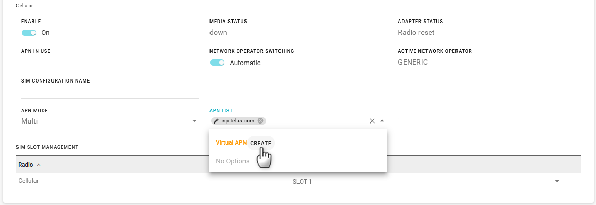

    Multi-APN Configuration
    When using a SIM that allows for multiple APNs, you can configure additional APNs.
    To configure an additional APN:

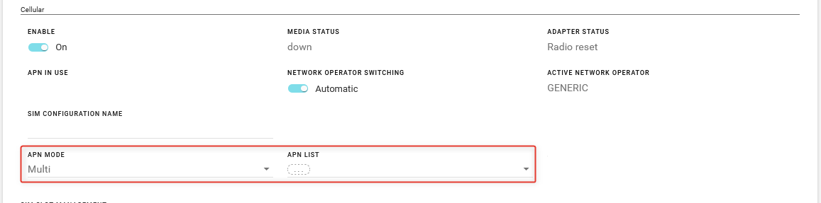

    1. Under APN MODE, select Multi.
    2. In the APN List, click CREATE. The Create New Virtual APN configuration screen appears.
    3. Configure the APN settings and then click CREATE.

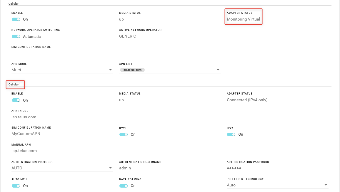

    You will see the Cellular Interface settings for each new APN that you create below the “parent” Cellular interface. The parent Cellular interface status becomes Monitoring Virtual.
    In the example below, the main Cellular interface has the sub-interface Cellular-1. This additional APN, when enabled, is the potentially active interface when the Cellular interface is in Multi APN mode.
