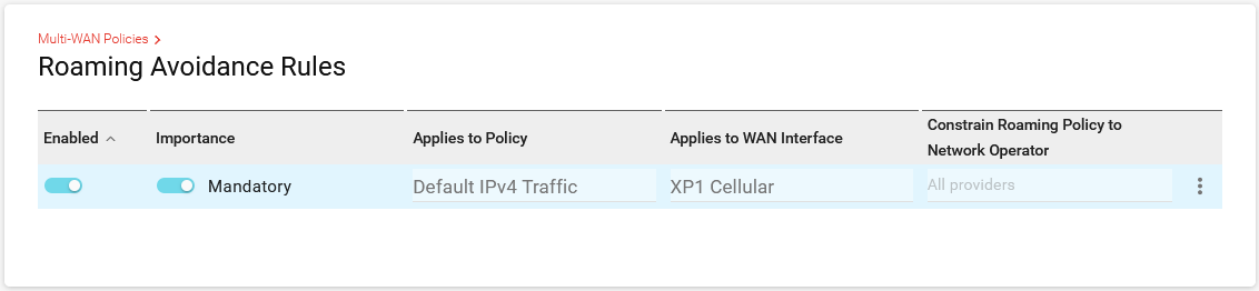

    Roaming Avoidance Rules
    • Enabled: Select to enable/activate this rule.
    • Importance: Enable to make the rule Mandatory. When the rule is set to mandatory, the WAN interface must never be used if Roaming. Disable to make the rule Optional. When the rule is optional, the WAN interface should not be used if Roaming and another WAN interface is available. If no other interface is available, use this optional interface even if it is roaming.
    • Applies to Policy: Apply this roaming rule against the specified WAN policy.
    • Applies to WAN Interface: Apply this rule against the specified interface used in the WAN policy configured in Applies to Policy. Note: this must be a cellular interface.
    • Constrain Roaming Policy to Network Operator: The roaming rule applies only if currently connected to the specified provider.
