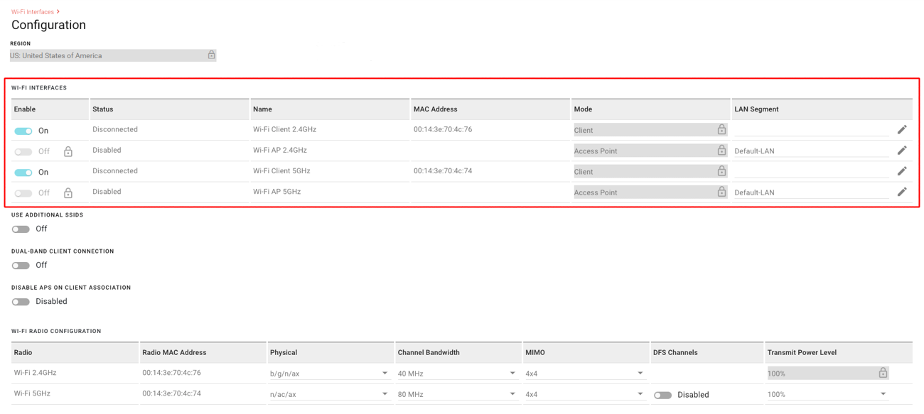

The mode of operation for each radio can be configured in the table below. Note that these are general radio settings that are shared by the Access Point and Client interfaces.
For each radio listed in the WI-FI RADIO CONFIGURATION table:
Select the MIMO (Multiple Input/Multiple Output) configuration for your installation to optimize throughput and signal quality.
The Wi-Fi antenna bank can have up to 5 Wi-Fi antennas connected. Antenna connectors 1–4 are used for MIMO, and connector 5 is used for scanning 5GHz in Client mode. To enable 5GHz operation, the XR80 must have antennas connected to connectors 1 and 5 (at minimum). See the XR Series Hardware Guide for more information about antennas.
For antenna connectors 1–4:
Enable DFS Channels to open up more Wi-Fi channels for the router to use, while preventing the router interfering with channels used by radar equipment (near airports, for example). With DFS Channels enabled, the router will switch channels if it detects radar equipment using the same channel. Unless you know that your other operating equipment is DFS capable, Sierra Wireless recommends leaving DFS Channels disabled.
Enabling DFS allows for more 5GHz channels, but may result in delayed connectivity at boot and in the presence of radar.
The Transmit Power Level setting allows you to restrict transmit power to the Wi-Fi antenna(s). The actual transmit power attained depends on a number of factors including the regulatory domain and the wireless channel used. Generally, a higher transmit power setting results in greater Wi-Fi range for the clients. Set for 100% by default, and adjust for network conditions. If clients are connecting with many other clients nearby, high transmit power can cause interference and impede throughput across connected clients.

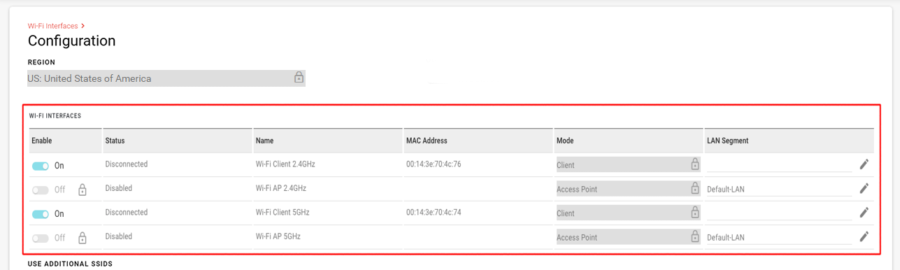

To configure an interface as an Access Point, click
at the end of an Access Point interface row in the WI-FI INTERFACES table (as shown above).
The Edit Wi-Fi Interface menu appears — configure the fields in any order.

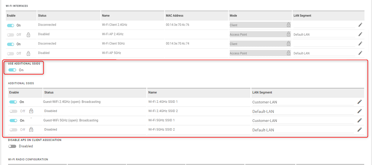

A USE ADDITIONAL SSIDS switch is below the Wi-Fi configuration table. This switch can be used when you require multiple SSIDs broadcasting on separate LAN segments which are configured for different security protocols.
When enabled, an Additional SSIDS table opens from which you can select, enable, and edit SSIDs (Virtual Access Points — “VAP”s).
Up to two additional SSIDs can be enabled for each of the access point interfaces (i.e., two for Wi-Fi AP 5GHz and two for Wi-Fi AP 2.4GHz).
To configure an additional SSID, click
at the end of the row in the ADDITIONAL SSIDS table (as shown above).
The Edit Wi-Fi VAP menu appears — configure the fields in any order.
This menu is identical to the Edit Wi-Fi Interface menu except there are no CHANNEL or BEACON INTERVAL settings. Those settings are inherited from the corresponding Wi-Fi Interface.

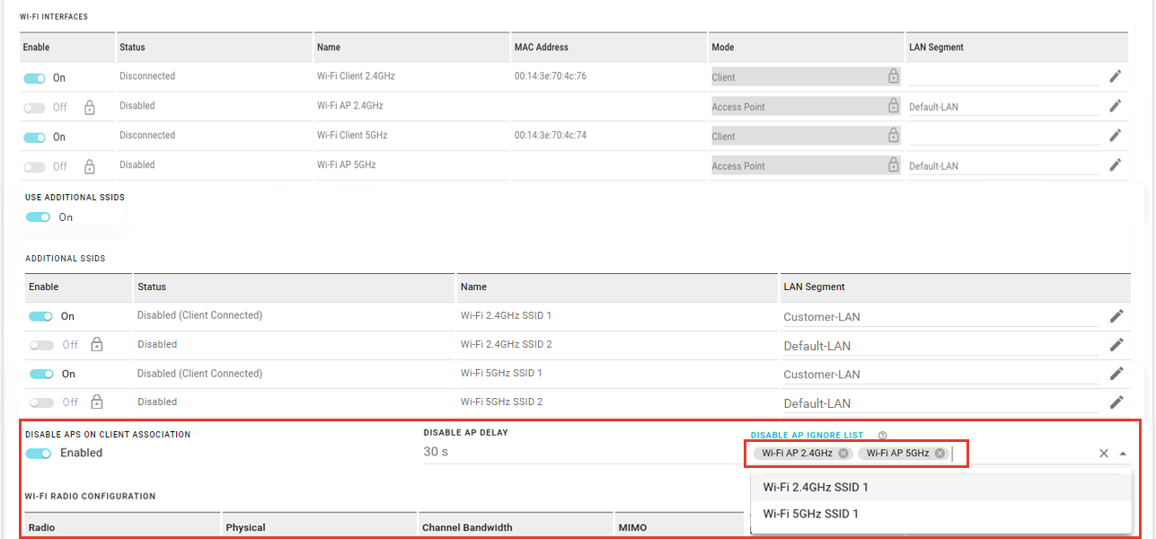

A DISABLE APS ON CLIENT ASSOCIATION switch is below the Wi-Fi configuration and Additional SSIDs tables. Enabling APS (Access Point Steering) on client association is typically done in wireless network management to improve the overall performance and user experience in scenarios where multiple access points are deployed.
This switch is disabled by default.
If this switch is enabled, the router will automatically disable some or all of its Access Points and Additional SSIDs when its Wi-Fi Client connects to a Wi-Fi access point (for example, when arriving at a service vehicle depot). Then, when the router disconnects from the access point, its own Access Points and Additional SSIDs are automatically re-enabled.
