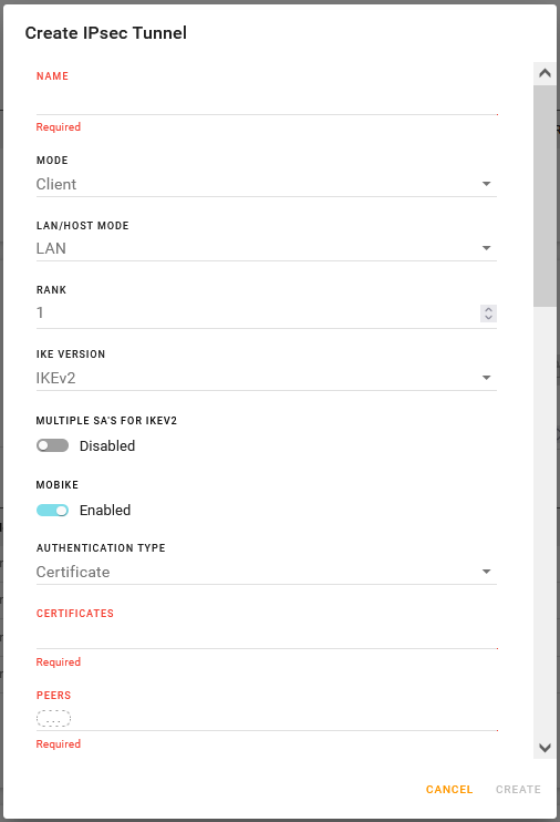

    Basic Configuration Steps
    To begin configuring a VPN tunnel:
    1. Go to Networking > VPN > IPsec Tunnels.
    2. Enable IPSEC FIPS MODE, if required. When enabled, a FIPS-approved cryptographic module is used for IPsec data protection, and only FIPS-approved cryptographic algorithms are allowed for tunnel configurations. Note: FIPS is only supported for IKEv2 tunnels.
    3. Select IPSEC FIPS MTU if IPSEC FIPS MODE is enabled (default is 1400; range is 100–1500). This sets the maximum transmission unit size for IPsec packets before encryption.
    4. Select the CONNECTION METHOD if you plan to configure multiple IPsec tunnels in Client mode. The CONNECTION METHOD gives you options for IPsec tunnel failover. The options are:
      • All: All tunnels attempt to connect simultaneously.
      • Random: AirLink OS establishes the connection by selecting a random tunnel from the list of configured tunnels. If a tunnel goes down, as determined by the VPN Link Monitor, AirLink OS randomly selects another tunnel from the list of configured tunnels.
      • Prioritized: AirLink OS establishes the connection by selecting the highest ranking tunnel in the list of configured tunnels. If a tunnel goes down, as determined by the VPN Link Monitor, AirLink OS selects the next highest-ranking tunnel. Ensure that each tunnel has a unique rank in the list. You can set a tunnel’s rank when you configure the IPsec Tunnel, or in the TUNNELS table when the CONNECTION METHOD is set to Prioritized.
    5. If the CONNECTION METHOD is Random or Prioritized, select the number of RETRY ATTEMPTS (default is 3; range is 0–10). This sets how many consecutive times an IPsec tunnel tries to connect before the next tunnel is used. Setting RETRY ATTEMPTS to 0 switches to the next tunnel immediately after first connection failure. The interval between retry attempts is set by a default backoff timer. This timer increases after each failed retry attempt from 10 seconds to a maximum of 600 seconds.
    6. Click CREATE IPSEC TUNNEL.
    7. Configure the router’s VPN mode and type of IPsec tunnel for your desired application. The following options are available:
    8. Click CREATE.

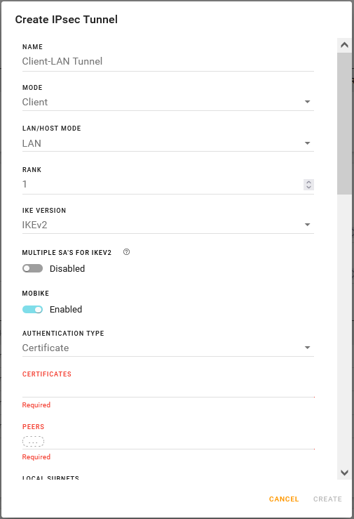

    Configuring a LAN-to-LAN tunnel in Client mode
    The settings in the procedure below are described in the IPsec Configuration Settings table above.
    To configure a LAN-to-LAN tunnel in Client mode:
    1. Enter a tunnel NAME.
    2. Set the router’s VPN MODE to Client.
    3. Set the LAN/HOST MODE to LAN.
    4. If you plan to use multiple IPsec tunnels in Client mode, set the RANK for failover priority.
    5. Select the IKE VERSION. When IKE VERSION is set to IKEv2, you can enable or disable:
      • MULTIPLE SA’S FOR IKEV2
      • MOBIKE
    6. Select the AUTHENTICATION TYPE.
      • After selecting Certificates, you must select any existing PEM Certificates on the router, or upload the certificate components to the router.
      • After selecting PSK, you must enter a text string for the pre-shared key.
    7. Enter the PEERS as one or more IPv4 or IPv6 IP addresses.
    8. Enter LOCAL SUBNETS, REMOTE SUBNETS and any EXEMPT SUBNETS.
    9. Enter LOCAL AUTHENTICATION ID and REMOTE AUTHENTICATION ID to match the credentials for your VPN server.
    10. Select the WAN INTERFACES for VPN traffic to and from the router, in order of priority.
    11. Select whether to START the tunnel when you finish configuration and click CREATE.
    12. Configure DEAD PEER DETECTION, if desired (requires you to configure the SECONDARY PEER FOR FAILOVER).
    13. Configure IKE settings.
    14. Select whether to use PERFECT FORWARD SECURITY (PFS).
    15. If PFS is enabled, configure ESP settings.
    16. Select VPN LINK MONITORS.
    17. Click CREATE.

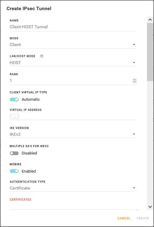

    Configuring a HOST-to-LAN tunnel in Client mode
    To configure a HOST-to-LAN tunnel in Client mode:
    3. Set the LAN/HOST MODE to HOST.
    5. Select the CLIENT VIRTUAL IP TYPE.
    6. Enter a VIRTUAL IP ADDRESS, if required by the CLIENT VIRTUAL IP TYPE.
    7. Select the IKE VERSION. When IKE VERSION is set to IKEv2, you can enable or disable:
      • MOBIKE
    8. Select the AUTHENTICATION TYPE.
    9. Enter the PEERS as one or more IPv4 or IPv6 IP addresses.

    Configuring a HOST-to-LAN tunnel in Server mode
    To configure a HOST-to-LAN tunnel in Server mode:
    2. Set the router’s VPN MODE to Server.
    4. Enable or disable USE DEFAULT VIRTUAL IP POOL(S).
    5. Enter the VIRTUAL IP ADDRESS POOL(S) (IPv4 or IPv6), if you have disabled USE DEFAULT VIRTUAL IP POOL(S).
    6. Select the IKE VERSION. When IKE VERSION is set to IKEv2, you can enable or disable:
      • MOBIKE
    7. Select the AUTHENTICATION TYPE.
    8. Enter the PEERS as one or more IPv4 or IPv6 IP addresses.
    9. Enter LOCAL SUBNETS and any EXEMPT SUBNETS.
    10. Enter LOCAL AUTHENTICATION ID and REMOTE AUTHENTICATION ID to match the credentials for your VPN server.
    16. Click CREATE.

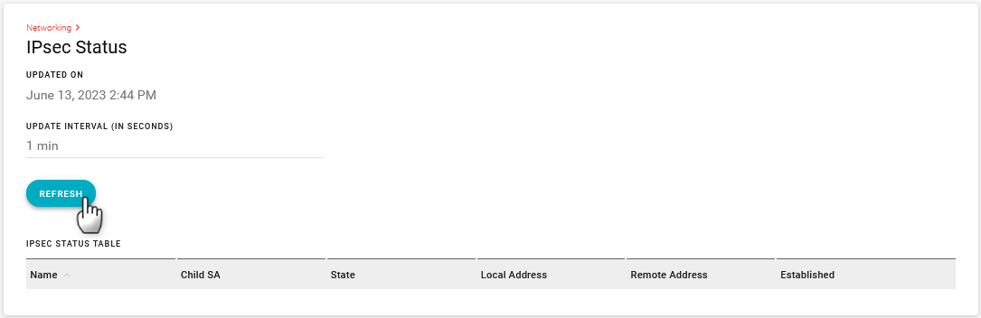

    IPsec Status
    Go to Status/Monitoring > Networking > IPsec Status to view IPsec tunnel status.
    The IPSEC STATUS TABLE shows you the main status items. You can click at the end of each row to view more information.
    • Click the UPDATE INTERVAL field to change the UPDATE INTERVAL. Enter a new interval (the ranges is 30–86400 seconds) and then click TAB or ENTER.
    • Click REFRESH to view the latest status without waiting for the UPDATE INTERVAL to elapse.
