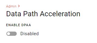

    DPAA should only be disabled for diagnostic purposes. Leave enabled (default) unless directed by Semtech support.
    To disable DPAA:
    1. Go to System > Admin > Data Path Acceleration.
    2. After being directed by Semtech support, click ENABLE DPAA. The setting changes to Disabled.
    3. Click Save.
    4. Reboot the router. This setting does not take effect (for either disable or enable) until after the router is rebooted.
    After concluding your diagnostic session with Semtech support, ensure that you re-enable the DPAA and reboot.
