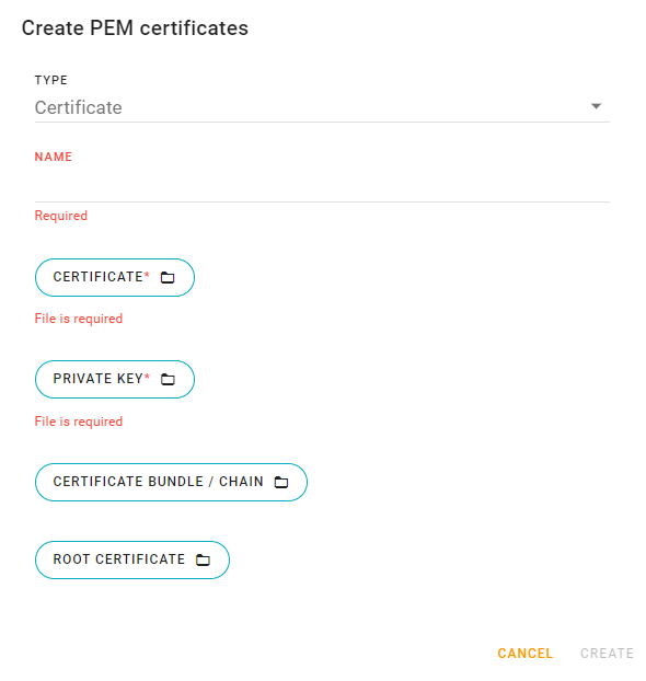

To create a security certificate:
The Create PEM Certificates window appears.
Configure the following settings to create a security certificate.
| SETTING | DESCRIPTION |
| TYPE | Select from Certificate or Root Certificate |
| NAME | Required name identifying the certificate |
| CERTIFICATE | Required for TYPE Certificate. Click to upload the certificate file |
| PRIVATE KEY | Required for TYPE Certificate. Click to upload the private key file |
| CERTIFICATE BUNDLE/CHAIN | Only shown for TYPE Certificate. This is currently not used by any functions on the router |
| ROOT CERTIFICATE | Required for TYPE Root Certificate. Optional for TYPE Certificate. Click to upload the root certificate file |
