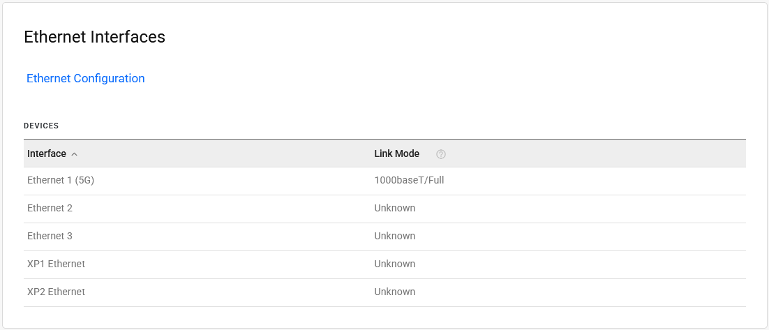

    Confirming Ethernet port configuration
    You can check your Ethernet port configuration under Status > Dashboard.
    For more detail, click on an Ethernet Port entry on the dashboard, and it will automatically take you to the Hardware Interfaces > Ethernet Interfaces > Configuration section.
    You can also check your Ethernet port configuration under:
    • Status > System > Ethernet Interfaces (Link Mode appears here)
