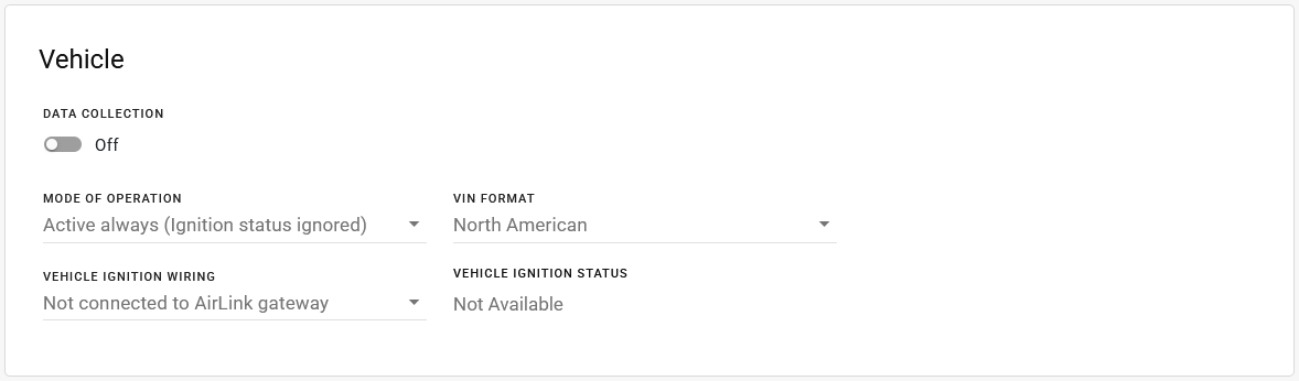

    Vehicle Settings
    Vehicle settings are a subset of telemetry. To collect vehicle ignition status and CAN bus data from the connected vehicle, configure:
    • Vehicle Ignition Wiring—how the router’s ignition input is wired to the vehicle. Ignition status is used by CAN bus data collection, GNSS parking mode, and other ignition-aware features.
    • VIN Format—VIN format used by the vehicle
    SETTING DESCRIPTION OPTIONS DEFAULT
    DATA COLLECTION Enables or disables data collection On/Off On
    MODE OF OPERATION Configures when data collection will be active
    • Active always (Ignition status ignored)
    • Active when Ignition is ON
    VIN FORMAT
    VIN FORMAT specifies how the router decodes the vehicle’s VIN (Vehicle Identification Number) to determine the vehicle’s Make, Model and Year for matching against configured proprietary message descriptors. The router can only decode VINs in North American format. This setting prevents false matches when the router is connected to a non-North American vehicle.
    When set to North American, the router decodes the VIN and matches the resulting Make, Model and Year against proprietary message descriptors to retrieve proprietary data points from the vehicle.
    When set to Other, the router does not decode or match the VIN.
    North American, Other North American
    VEHICLE IGNITION WIRING This setting determines which input line the router monitors for ignition status. Select the option that matches how the vehicle ignition line has been connected to the router.
    • Not connected to AirLink gateway
    • Connected to AirLink gateway Ignition Sense input line
    • Connected to AirLink gateway GPIO input line
    VEHICLE IGNITION STATUS Current vehicle ignition status. Read only. On, Off, Not Available N/A
