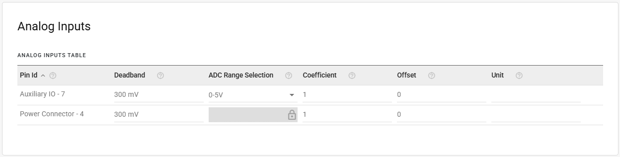

Analog inputs monitor a voltage range in small increments. This allows you to monitor equipment that reports status as an analog voltage. Examples include:
In the Analog Inputs Table you can transform the voltage readings to a more convenient unit of measurement. For example, degrees Celsius or Fahrenheit for temperature, liters for volume, etc.
Before you configure, you need to locate or calculate the coefficient and the offset values.
Consult the user documentation for the equipment you want to monitor. It should provide you with the coefficient to convert volts to the appropriate unit of measurement and the offset value (the difference between the equivalent value for 0 volts and 0), or provide information on equivalent values for voltage readings from which you can calculate the coefficient and offset. (If this information is not available in the user documentation, contact the manufacturer.)
For example, if the equipment monitors temperature, and has a scale from 0 volts to 30 volts, the equipment specifications should provide information similar to the following:
0 V is equivalent to –20°C
30 V is equivalent to 100°C
This is expressed algebraically as follows:
a * 0V + b = –20C
a * 30V + b = 100C
where:
a = coefficient
b = offset
For this example, you can calculate a as follows:
(a * 30V + b) – (a * 0V + b) = 100C – (–20)
a * 30V = 120V
a = 4
To calculate b, substitute a into the first equation above:
4 * 0V + b = –20
b = –20
For each of the analog inputs you want to configure:
Go to System > I/O > Analog Inputs.
Enter the values for the coefficient and offset. (In this example, the coefficient is 4 and the offset is –20.)
AirLink OS will show the value of the transformed analog input.

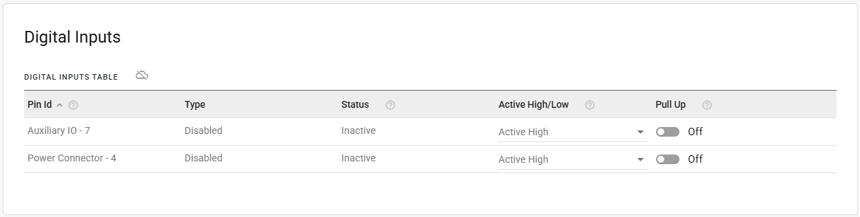

Digital inputs monitor contact closures on a switch. This allows you to monitor changes such as:
When the trunk of a vehicle is opened or closed
The Digital Inputs Table displays:
For each of the digital inputs you want to configure:
Go to System > I/O > Digital Inputs.
In the DIGITAL INPUTS TABLE, select Active High or Active Low.
Enable/disable the Pull Up.
The power connector GPIO (pin 4) digital input can also be used to put the device into a standby mode and to wake the router up. To configure this, see Configuring Power Settings (MCU) .
