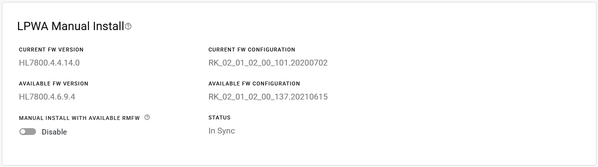

    LPWA Manual Install
    This feature allows you to manually install LPWA radio module firmware. If the Current and Available firmware versions or configurations do not match, or if the router is experiencing LPWA connectivity issues, please contact AirLink Support for assistance before using this feature.
    Use this feature only under guidance from the AirLink Support team. Installing an incompatible firmware or configuration may impact LPWA connectivity.
