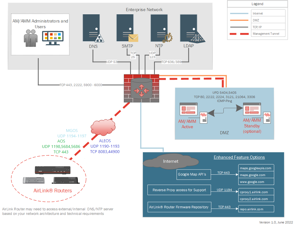

The AM/AMM requires ports in the firewall to be open in order to function correctly. The sections below provide information on which ports need to be open and what their purpose is.
Notes:
- All firewall rules must be stateful.
Deployment Diagram
Firewall Port Requirements for AirLink OS, MGOS and ALEOS Deployments

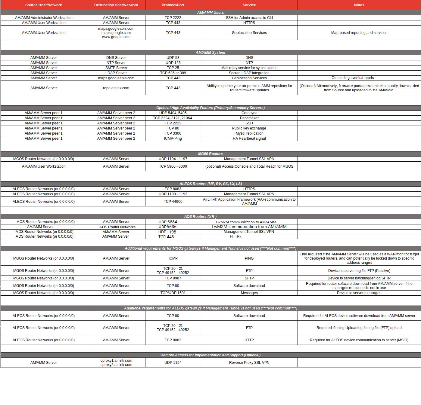

| Source Host/Network | Destination Host/Network | Protocol/Port | Service | Notes |
| AM/AMM Users | ||||
| AM/AMM Administrator Workstation | AM/AMM Server | TCP 2222 | SSH for Admin access to CLI | |
| AM/AMM User Workstation | AM/AMM Server | TCP 443 | HTTPS | |
maps.googleapis.com maps.google.com www.google.com |
TCP 443 | Geolocation Srevices | Map-based reporting and services |
| AM/AMM System | ||||
| AM/AMM Server | DNS Server | UDP 53 | DNS | |
| AM/AMM Server | NTP Server | UDP 123 | NTP | |
| AM/AMM Server | SMTP Server | TCP 25 | Mail relay service for system alerts | |
| AM/AMM Server | LDAP Server | TCP 636 or 389 | Secure LDAP Integration | |
| AM/AMM Server | maps.googleapis.com | TCP 443 | Geolocation Services | Geocoding events/reports |
| AM/AMM Server | repo.airlink.com | TCP 443 | Ability to update your on-premise AMM repository for router firmware updates | (Optional) Alternatively, firmware packages can be manually downloaded from Source and uploaded to the AM/AMM |
| Optional High Availability Feature (Primary/Secondary Servers) | ||||
| AM/AMM Server peer 1 | AM/AMM Server peer 2 | UDP 5404, 5405 | Corosync | |
| AM/AMM Server peer 1 | AM/AMM Server peer 2 | TCP 2224,3121,21064 | Pacemaker | |
| AM/AMM Server peer 1 | AM/AMM Server peer 2 | TCP 2222 | SSH | |
| AM/AMM Server peer 1 | AM/AMM Server peer 2 | TCP 80 | Public Key Exchange | |
| AM/AMM Server peer 1 | AM/AMM Server peer 2 | TCP 3306 | MySQL replication | |
| AM/AMM Server peer 1 | AM/AMM Server peer 2 | ICMP-Ping | HA Heartbeat signal | |
| MG90 Routers | ||||
| MGOS Router Networks (or 0.0.0.0/0) | AM/AMM Server | UDP 1194-1197 | Management TUnnel SSL VPN | |
| AM/AMM User Workstation | AM/AMM Server | TCP 5900-6000 | (Optional) Access Console and Total Reach for MGOS | |
| ALEOS Routers (MP,RV,GX,LX,LS) | ||||
| ALEOS Router Networks (or 0.0.0.0/0) | AM/AMM Server | TCP 8083 | HTTPS | |
| ALEOS Router Networks (or 0.0.0.0/0) | AM/AMM Server | UDP 1190-1193 | Management Tunnel SSL VPN | |
| ALEOS Router Networks (or 0.0.0.0/0) | AM/AMM Server | TCP 44900 | AirLink Application Framework (AAF) communication to AM/AMM | |
| AirLink OS routers (XR, RX55 Wi-Fi Plus, RX400, EX400) | ||||
| AirLink OS router Networks (or 0.0.0.0/0) | AM/AMM Server | UDP 5684 | LwM2M bootstrap service | |
| AirLink OS router Networks (or 0.0.0.0/0) | AM/AMM Server | UDP 5686 | LwM2M device management service | |
| AirLink OS router Networks (or 0.0.0.0/0) | AM/AMM Server | UDP 1198 | Management Tunnel SSL VPN | |
| AirLink OS router Networks (or 0.0.0.0/0) | AM/AMM Server | TCP 443 | HTTPS | |
| Additional Requirements for MGOS gateways if Management Tunnel is not used (***Not common***) | ||||
| MGOS Router Networks (or 0.0.0.0/0) | AM/AMM Server | ICMP | Ping | Only required if the AM/AMM server will be used as a WAN monitor target for deployed routers, and can potentially be locked down to specific address ranges |
TCP 20-21 TCP 49152-49252 |
FTP | Device to server log file FTP (Passive) |
| MGOS Router Networks (or 0.0.0.0/0) | AM/AMM Server | TCP 9987 | SFTP | Device to server batchlogger log SFTP |
| MGOS Router Networks (or 0.0.0.0/0) | AM/AMM Server | TCP 80 | Software download | Required for router software download from AM/AMM server if the management tunnel is not in use |
| MGOS Router Networks (or 0.0.0.0/0) | AM/AMM Server | TCP/UDP 1501 | Messages | Device to server messages |
| Additional Requirements for ALEOS routers if Management Tunnel is not used (***Not common***) | ||||
| ALEOS Router Networks (or 0.0.0.0/0) | AM/AMM Server | TCP 80 | Software download | Required for ALEOS router software download from AM/AMM server |
FTP | Required if using Uploadlog for log file (FTP) upload |
| ALEOS Router Networks (or 0.0.0.0/0) | AM/AMM Server | TCP 8082 | HTTP | Required for ALEOS router communication to server (MSCI) |
| Remote Access for Implementation and Support (Optional) | ||||
| AM/AMM Server |
cproxy1.airlink.com cproxy2.airlink.com |
UDP 1194 | Reverse Proxy SSL VPN | |
