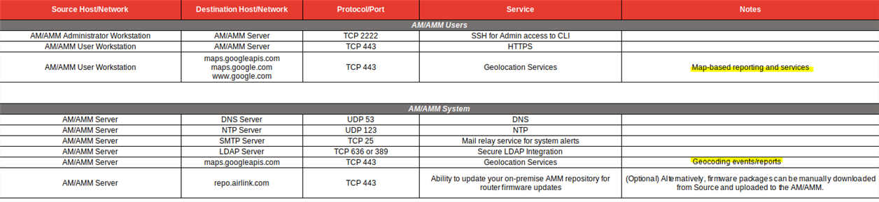

The following table shows which ports are necessary.
Firewall Port Requirements for Google Maps
