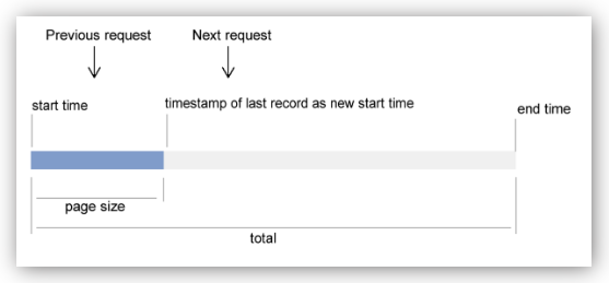

    Response Info (when greater than 25,000 records returned) :
    “pagesize” : number of records returned
    “total”: total number of records found
    To query for the rest of the data:
    1. Create a new API request with the same parameters.
    2. Use the timestamp of the last record returned from the previous request as the new start time plus 1 millisecond.
    3. End time remains unchanged.
