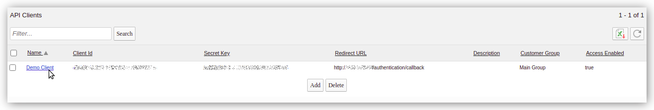

    1. Select Develop>API Clients.
    2. The user can see API clients from its own group, its child groups and its parent groups. API clients that belong to the parent group cannot be editted.
    - name of the API client.
    - API client id assigned by the AMM.
    - Secret key assigned by the AMM.
    - Redirect URL is an important part of OAuth2 authorization code flow. After a client is successfully authorized by an authenticated user, the AMM will redirect the user back to the client application with an authorization code in the URL as query parameter.
    - description.
    - customer group that the API client is assigned to.
    - if API client is enabled or not.
