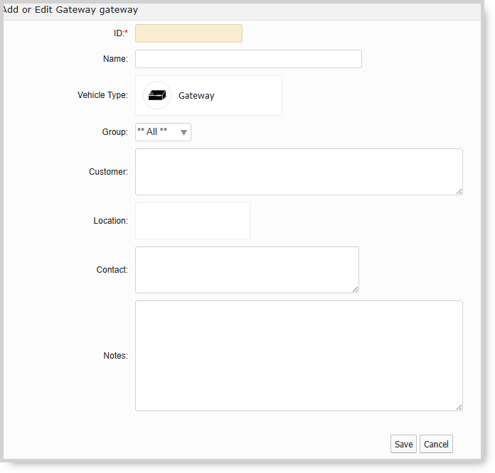

    2. Click on the Add button to display the “Add or Edit Gateway” screen where configuration settings can be changed, as shown in the figure below:
      Accessing the Add or Edit Gateway Screen.
    3. Enter the ID of the AOS gateway. This is the electronic serial number.
    4. Enter the Name that is used to identify the gateway.
    5. Optionally add Group, Location, Contact and Notes.
    6. Click Save. A CSV file titled _sierrawireless_bootstrap_keys will be created. Save it to a local location where you can easily find it.

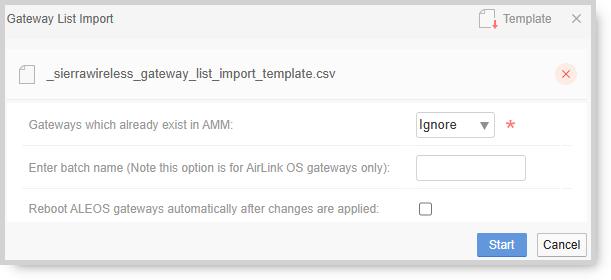

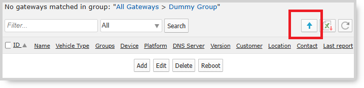

    To transition multiple AirLink OS gateways to the AMM, use the following procedure
    1. Login to the AMM as a user with access to Admin > Devices > Gateways.
    2. Click on up arrow to import the Gateway List. If need be, the template can be downloaded from this screen.
      Adding Multiple AOS Gateways
    3. Select the file with the multiple AOS devices in it. The file can have a mix of different types of gateways.
    4. Optionally enter a Batch Name. The Batch Name is a tag that can be used to categorize when an AOS gateway was added. It is used in Admin > Devices > AirLink OS Keys. The Batch Name should be limited to 100 characters.
      Gateway List Import
      Gateway List Import
    5. Click on Start
    6. The AMM will process the entries and show a report. A CSV file, titled _sierrawireless_bootstrap_keys, will be created containing all the AOS devices added. Save this file to a location where it can be easily found.

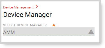

    2. Login to the AOS gateway as user admin
    3. Navigate to System > Device Management > Device Manager
    4. You will see that the Device Manager is set to ALMS. Change it to AMM

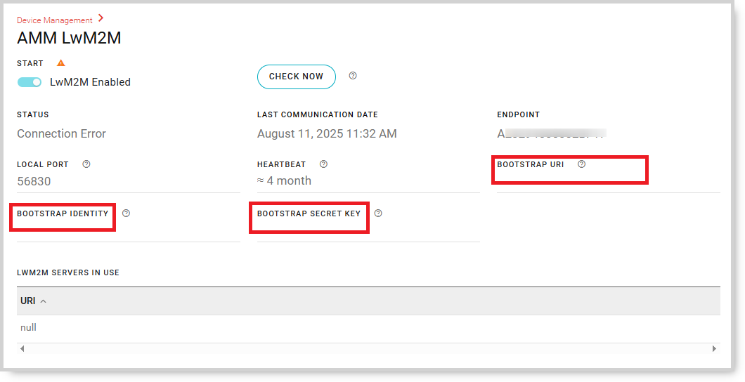

    5. Navigate to System > Device Management > AMM LwM2M. From the _sierrawireless_bootstrap_keys file, copy the BOOTSTRAP URI for that particular AOS gateway and paste into the AMM LwM2M field BOOTSTRAP URI .
    6. From the _sierrawireless_bootstrap_keys file, copy the Bootstrap Identity for that particular AOS gateway and paste into the AMM LwM2M field BOOTSTRAP IDENTITY
    7. From the _sierrawireless_bootstrap_keys file, copy the Bootstrap Secret Key for that particular AOS gateway and paste into the AMM LwM2M field BOOTSTRAP SECRET KEY

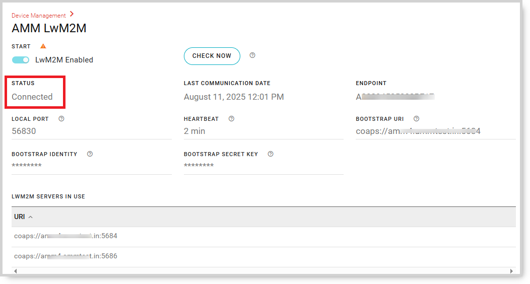

    8. Save the changes on the gateway. The AOS LwM2M process will start and the STATUS will change to Starting and if there are no errors, change to Connected.

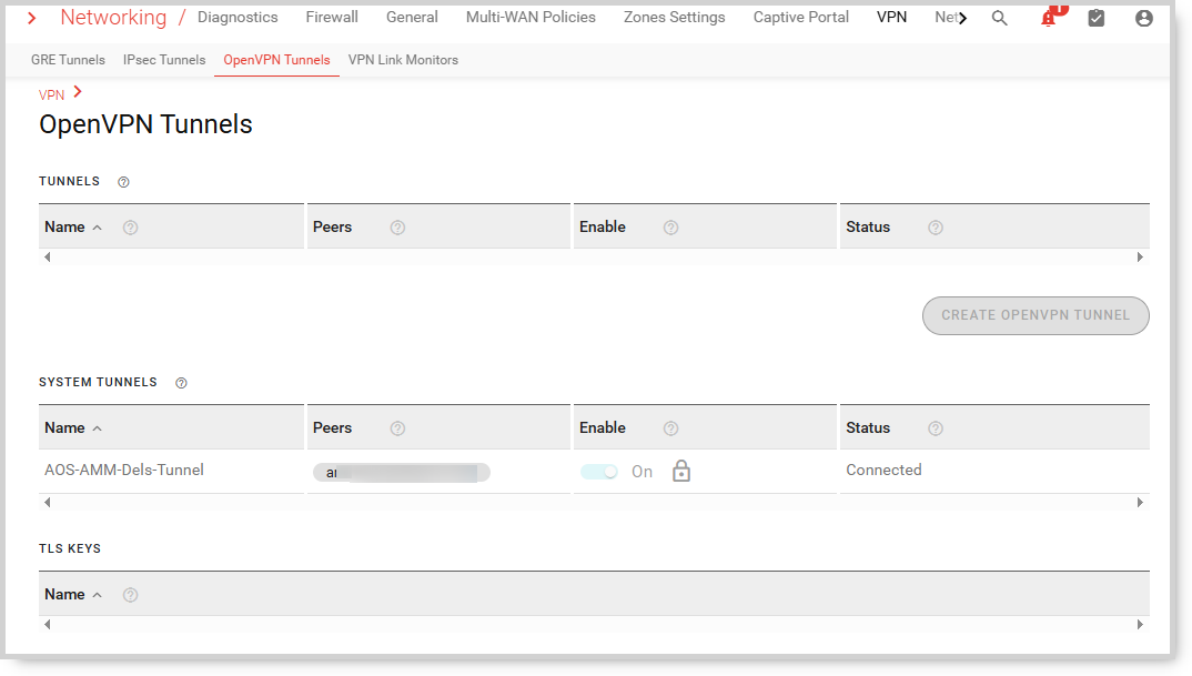

    9. Once the LwM2M is connected, the OpenVPN tunnel process will automatically start. To check the process, go to Networking > VPN > OpenVPN Tunnels and view the SYSTEM TUNNELS.

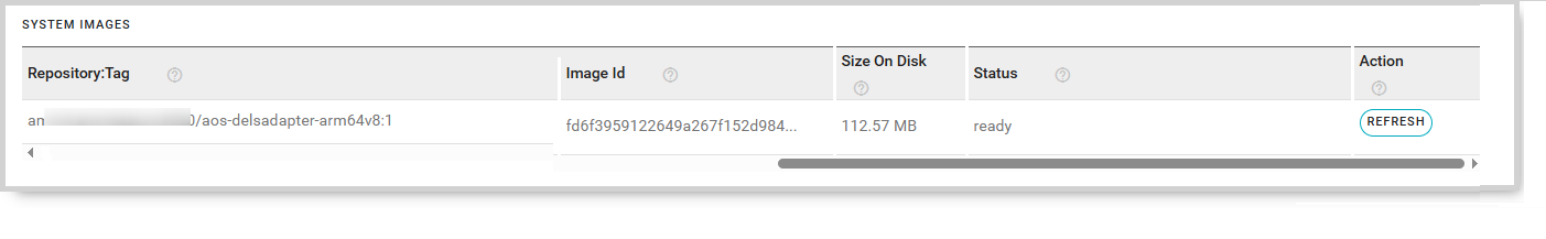

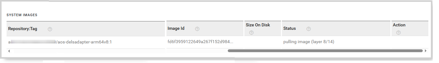

    10. To check if the container is being pulled, navigate to Apps > Container Applications (Early Adopter) > Images. Under SYSTEM IMAGES, the DelsAdapter status should start and transition to show as ready.
      aos-delsadapter status is downloading
      aos-delsadapter status is ready

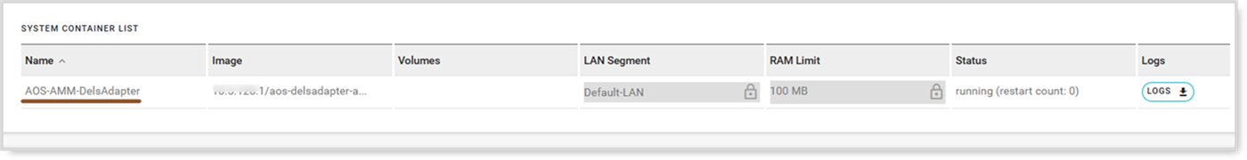

    11. Once the aos-delsadapter status is ready, the AOS-AMM-DelsAdapter should have a status of running.
      AOS-AMM-DelsAdapter status is running

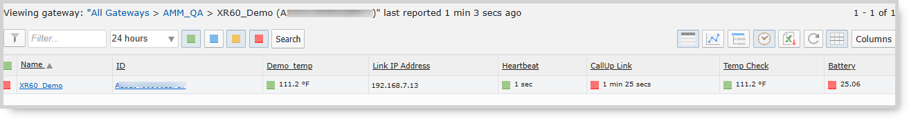

    12. The gateway should begin reporting all its stats to the AMM dashboard.
      AOS gateway reporting to AMM
