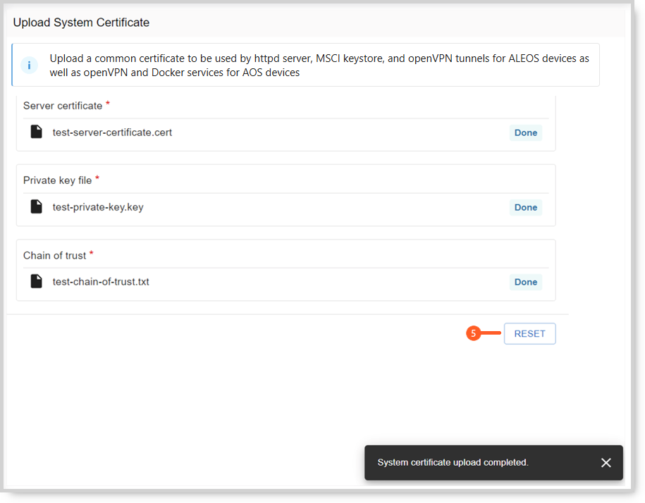

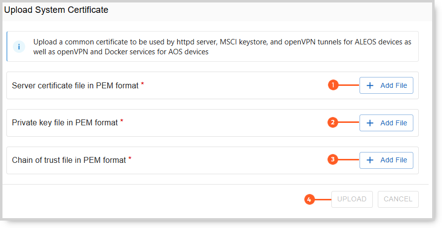

    1. To upload a system certificate, go to Admin > System > Upload Certificate.
    2. Select to add the server certificate file.
    3. Select to add the private key file.
    4. Select to add the chain-of-trust file.
    5. After the files are added successfully, select UPLOAD to upload the files to AMM.
    • If any of the files have an error, the system will display an error message. You can then remove the invalid file and upload the correct file again.
    • You can cancel the upload, by selecting CANCEL.
    • If the upload is successful, the status will be marked as Done.
    • To start a new upload, select RESET. The previous certificate will be rotated to a backup directory.

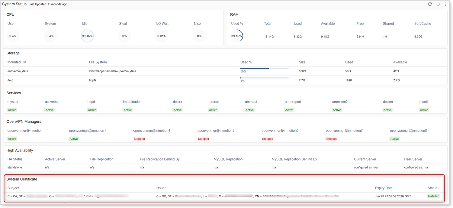

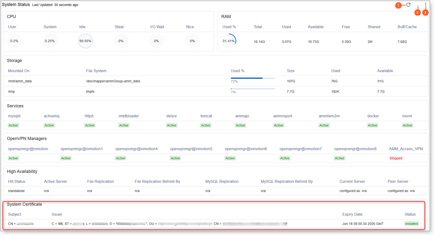

    Viewing System Certificate Status
    You can go to the Admin > System > Status to view the uploaded system certificate status. The System Status screen displays a brief description of the certificate usage and its status. Status can be either Installed or Not installed
