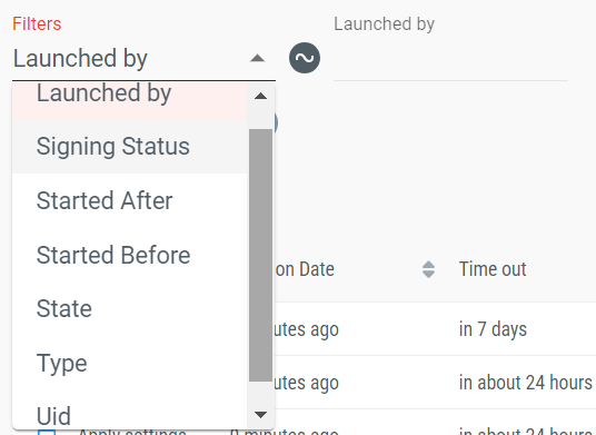

You can use filters to locate and identify operations for approval or rejection. Click ADD FILTER.
