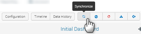

    Before working with templates in ALMS, ensure that you synchronize the router. The synchronization updates all the information from the router, and ensures that router configuration data is up to date in ALMS.

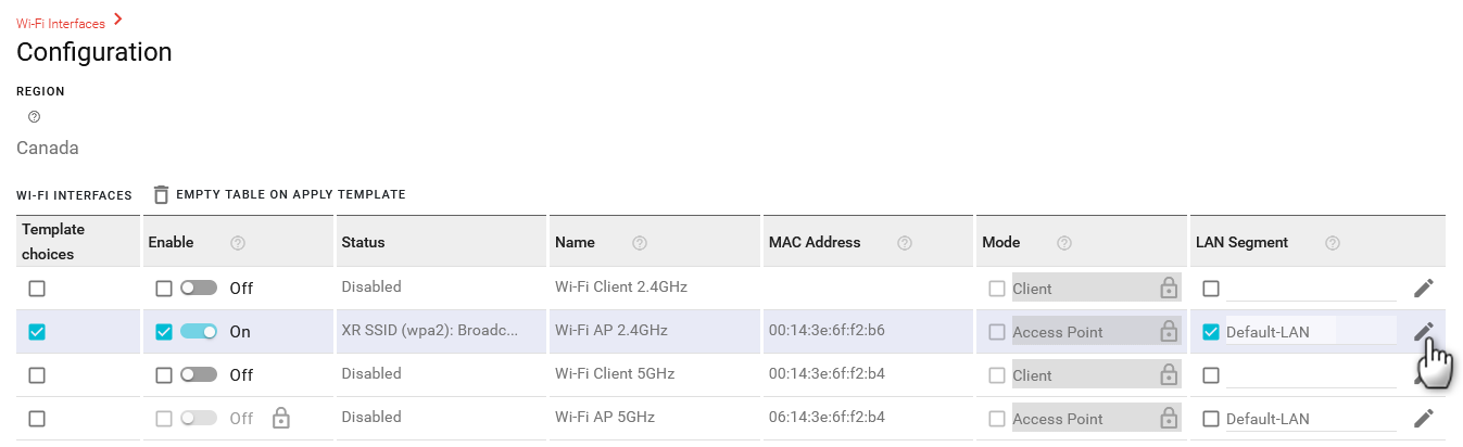

      You can also select a checkbox in a table to add the contents of a table row to the template, or click to delete/reset a table row (or an entire table) in the template.

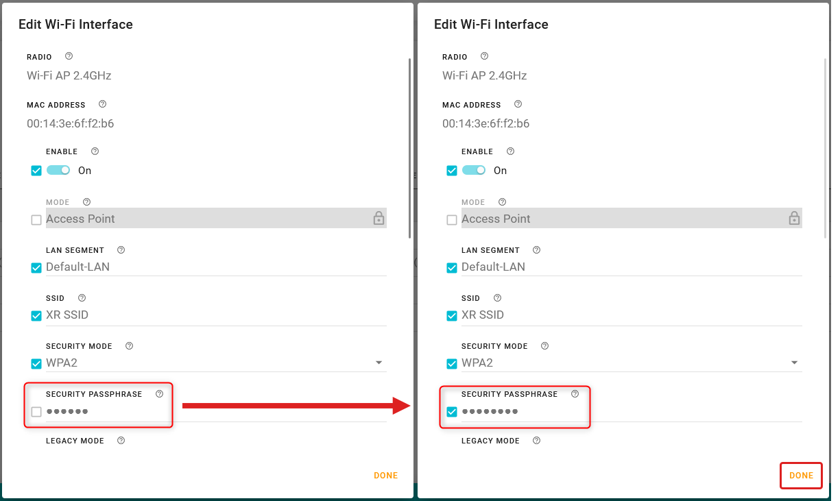

    Adding Passwords to a Template
    For security reasons, sensitive information such as passwords and passphrases cannot be extracted from the router and copied into a new template. If you select any configurations that include a password, you must enter the password before you can add it to the template. Note that this procedure only adds a password to the template. Any passwords on the router from which you are creating the template cannot be changed in template mode.

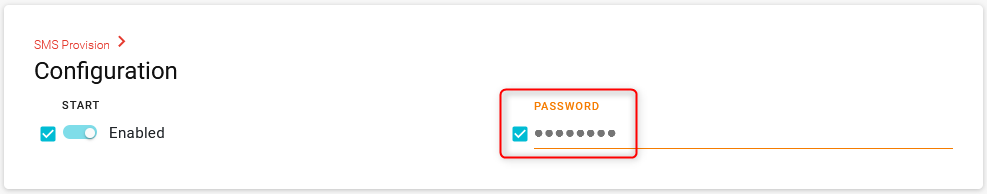

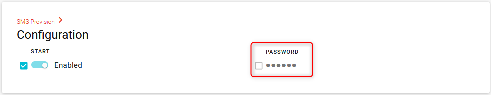

    Some password fields are readily visible in template mode, such as the SMS password shown below.
    To add the password to the template, click the password field and enter the password.
    Tip: As you enter the password, click Show/Hide to reveal the entry in plain text.
    After entering the password, select the checkbox, and the password is included in the template.
    Other passwords can be found within a configuration menu that will appear after clicking (edit) in a table, for example.
    In this case, you can enter the password or passphrase and then click DONE.
