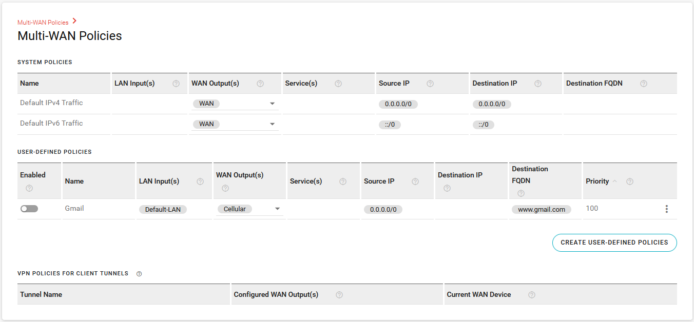

    WAN policies can be configured under Networking > Multi-WAN Policies.
    Multi-WAN Policies
    Under Multi-WAN Policies, you can configure the top-level rules for data traffic management between LAN and WAN. The Multi-WAN policies are divided into the following categories:
    • System Policies: AirLink OS has two default rules already defined: the default routes for IPv4 and IPv6 traffic (priority 998 and 999 respectively). Traffic that is not carried by any other Multi-WAN policy will use one of these two rules. These default rules use the default system WAN zone. You can edit the WAN Output(s) fields to use other zones or interfaces.
    • User-Defined Policies
    • VPN Policies for Client Tunnels: These policies define what interfaces will be used for IPsec tunnels or OpenVPN tunnels. They are automatically created when a VPN tunnel is configured.
    Multi-WAN rules define the WAN devices that can carry various types of data traffic. You can select the traffic type based upon the origin (LAN bridges/zones), destination ports(services), source/destination addresses, or FQDN.
    In the case that you have rules with overlapping elements, you can assign a priority to your rules, from 100 to 999. For example, if you have a rule with Source IP of 192.168.1.100 at Priority 100 and a rule with Source IP of 192.168.1.1/ 24 at Priority 101, traffic from 192.168.1.100 is routed to 192.168.1.100, and the other rule is ignored.
    • Enabled: Sets whether the policy rule is active or not
    • Name: A description for the policy.
    • LAN Input(s): Specifies the source of the traffic. If left blank, the policy applies to all traffic from any LAN device or traffic from the router itself. For example, router traffic includes ALMS LWM2 traffic and DNS queries. You can select LAN Segments (configured under Networking > Zones > LAN Segments) or LAN Zones.
    • WAN Output(s): Specifies the ordered list of interfaces the traffic can be carried over. This can be configured using a Zone or specific WAN interfaces. Default policies use the WAN zone to define the default device order. The default device preference is Ethernet, Wi-Fi, Cellular, and finally USB interfaces (USB interfaces may not be implemented yet).
      • To change the order, you can either select interfaces in priority order, or you can define a new Zone. Zones are configured under Networking > Zones > System Zones.
      • For example, if traffic from Default-LAN should use Cellular 1 first, then Cellular 2 (if Cellular 1 is unavailable), you can select Cellular 1 and then Cellular 2. Alternatively, you can create a new zone called MyZone with Cellular 1 and Cellular 2. Then MyZone can be applied to any policy rule.
    • Service(s): Specifies a protocol/destination port number to identify the traffic. If left empty, all traffic types (TCP, UDP, ICMP) will be matched against this policy. You can configure Services at Networking > Zone Settings > Services.
    • Source IP and Destination IP: Specifies a source/destination to match against this traffic (either IPv4 or IPv6). You can enter an IPv4 or IPv6 IP address, and AirLink OS will validate it. Note that if both IPv4 and IPv6 traffic is to be selected, two policies must be created.
    • Destination FQDN: You can specify a Destination FQDN instead of a fixed Destination IP address. To use a Destination FQDN, clear the Destination IP field. Click the Destination FQDN field to select a pre-configured FQDN, or click CREATE to create a new FQDN entry. You can also create a new FQDN entry under Zones settings > Fully Qualified Domain Names.
    • Priority: Defines the order in which policies are evaluated, in ascending order. For example, if you create a rule with priority 100, it will apply first and override the default 998 and 999 policies. Each policy must have a unique priority; AirLink OS does not allow policies with identical priorities.
    Click CREATE USER-DEFINED POLICIES to configure and add a user-defined rule.
