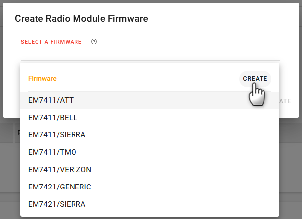

    1. Click CREATE.

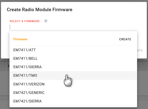

    2. Click on the entry line to select the desired module/carrier combination from the list.

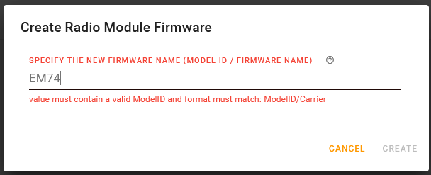

      If you don’t find your desired radio module/carrier combination in the list:
        a. Click on the entry line and click CREATE.
        b. Enter the new firmware name (Model ID / Firmware Name)
        c. Click CREATE to create an instance with this value.

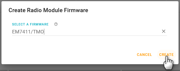

    3. Click CREATE to add a radio module firmware entry in the table.
    4. Click SAVE and a new row for the selected carrier appears. The FIRMWARE CONFIGURATION and FIRMWARE VERSION fields are blank.
